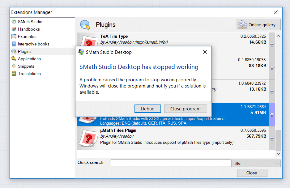

#8 Posted: 2018/10/24 10:26:51
Igor Skarine
Igor Skarine
14 likes in 97 posts.
Hello Davide,
The plugin doesn't work with the latest Smath beta.
It crashes right away during plugin installation:
I tried it in office on Win10 and at home on Win 7,
all the same. I'm using 32-bit SS on 64-bit Windows.
Davide Carpi 2018/10/24 12:52:00
#9 Posted: 2018/10/24 12:54:08
1,443 likes in 2,935 posts.
Thank you, confirmed.
Latest release deleted.
