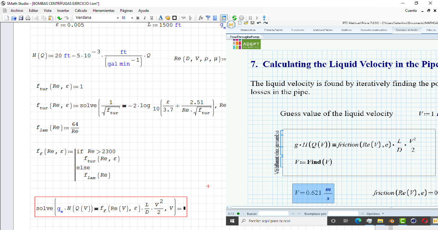

hi guys it's me again xD
There is an exercise to find the discharge speed of a pump in Mathcad Prime ... when I try to do it in SMath Studio I am unsuccessful
Resolving functions based on other functions in SMath Studio - Mathcad Prime
I leave the pdf of Mathcad Prime and the SM File
Liquid Flow Through a Pump.sm (42.2 KiB) downloaded 1063 time(s).
FlowThroughaPump.pdf (690.73 KiB) downloaded 714 time(s).

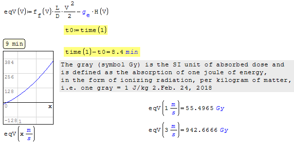

#4 Posted: 2021/10/3 20:42:55
Liquid Flow Through a Pump Brute Force Plot.sm (56.99 KiB) downloaded 1166 time(s).
