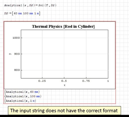

I get the following error: "The input string does not have the correct format" in Smath Studio 98.6606
Carlos
#3 Posted: 2018/2/2 17:59:50
2,340 likes in 4,041 posts.
The same error with earlier versions. I've reproduced it on 0.98.6484.
Seems like locale related issue in the graph plug-in.
