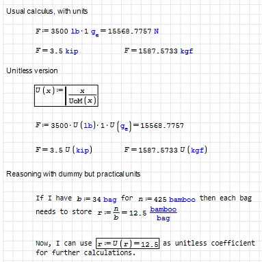

For me units have 2 purposes:
1. Getting quickly understandable numbers
2. Checking errors (unit consistency)
Hi. I agree. Here, a way to get that. Also, notice that you can use almost any other unicode symbol for U(x), or 'U(x), i.e. U in blue.
DummyUnits.sm (9.65 KiB) downloaded 1047 time(s).
#22 Posted: 2022/4/19 14:58:11
This is where Smath is great with the possibility to use any variable as a unit. I even sometimes define units such as "bag" or "bamboo"! And doing that without using an actual "unit" but only a variable, allows to bypass Smath's unit consistency check.
That's what I have exemplified ad noseum.
However identifying what bamboo means.
Per say: approximate/discretize a PDF ... explicit result.
Pretty easy to explicit sin(30)= rad/°
Engineers manage well non SI projects.

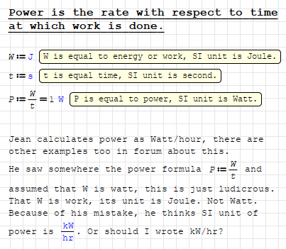

And sometimes that numbers tend to make serious mistakes, like that kW/hr pump power calculation of his.
Not even a typo, he divided 1hr (3600s) to g.e (9.8), found 367 and used it in that abomination.
I have never seen that kW/hr usage anywhere, but interestingly his pump power results have it.
It should even be kW, not even kW*hr. What will be benefit of pump electrical consumption calculation?
Everything that works, and is understandable, is good, very good!
Real problem is, some of his engineering calculations, especially unitless ones, have some serious mistakes.
Most of his viscosity related calculations are wrong due to his lack and denial of unit usage.
If he bothered and learned how to use units, he would see engineering is not just operations on given numbers.

We wouldn't, unless he didn't propagate new users about his ridiculousness.
He wrongly claim SI units are not for engineering calculations.
I don't know what the hell this statement means, everyone in the world uses SI now.
He can use whatever he want, I personally won't care. He is a lost case.
But encouraging new users (also possibly young students) non-scientific, incorrect and illogical ways is unacceptable.
