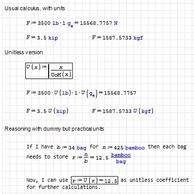

For me units have 2 purposes:
1. Getting quickly understandable numbers
2. Checking errors (unit consistency)
Hi. I agree. Here, a way to get that. Also, notice that you can use almost any other unicode symbol for U(x), or 'U(x), i.e. U in blue.
DummyUnits.sm (9,65 КиБ) скачан 1215 раз(а).

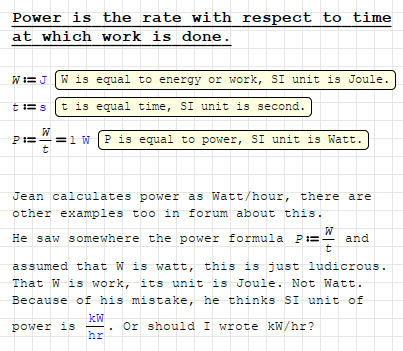

#34 Опубликовано: 21.04.2022 10:23:05
I find Jean's unitless calculations very very elegant and fascinating.
Problem is, his calculations are hard to read. Harder to understand, illogical to revise since they are bound to certain units.
Everything is everywhere, they are color racket and there is no heuristical walkthrough in his samples.
There are even some converting numbers, strain you to understand where they come from
Which those convert numbers would be redundant if he bothered to use embedded units.
Those numbers doesn't look not very elegant on page, and not knowing where they come from at first glance is not fascinating.
And sometimes that numbers tend to make serious mistakes, like that kW/hr pump power calculation of his.
Not even a typo, he divided 1hr (3600s) to g.e (9.8), found 367 and used it in that abomination.
I have never seen that kW/hr usage anywhere, but interestingly his pump power results have it.
It should even be kW, not even kW*hr. What will be benefit of pump electrical consumption calculation?
