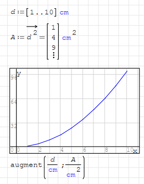

1) How to build a graphs of function if the document has units of measurement? If I do "Ignore inits", then everything works. But I would like to with units of measurements
111.sm (33.1 KiB) downloaded 969 time(s).

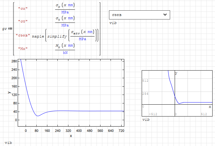

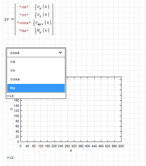

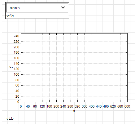

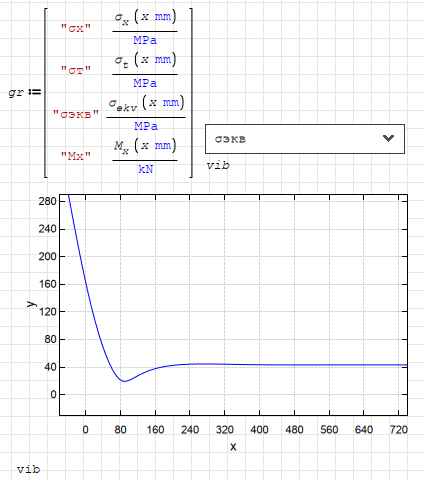

2) Using plugin ComboBox I want to build graphs of 4 functions
Graphs of functions σ.x(x), σ.t(x), Mx(x) are built.
File not found. File not found. File not found.
Graph of functions σ.ekv(x) is not build. Why?

Don't "Ignore units", eliminate them.
Easiest way is to divide.

Очень странное поведение, возьму на заметку. Компоненту не нравится выражение под знаком корня.

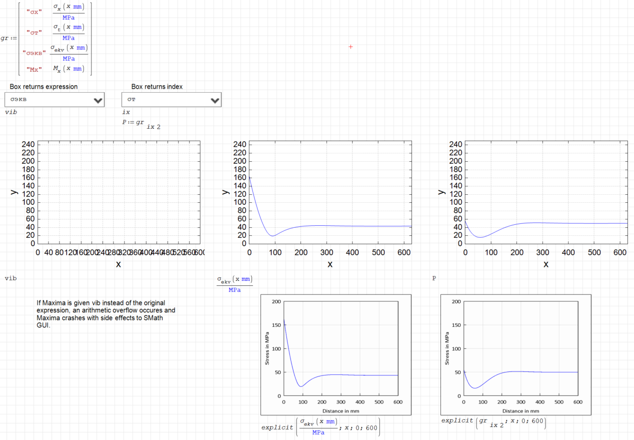

The success of plotting seems to depend on how the expression is accessed. Possibly it is a Combobox issue.
BTW, in Maxima, the intermediate definition of P is not required. This is a necessary step for X-Y Plot only.
Если строить график отдельно, то он строится, проблем нет. Именно при Combobox'е не хочет

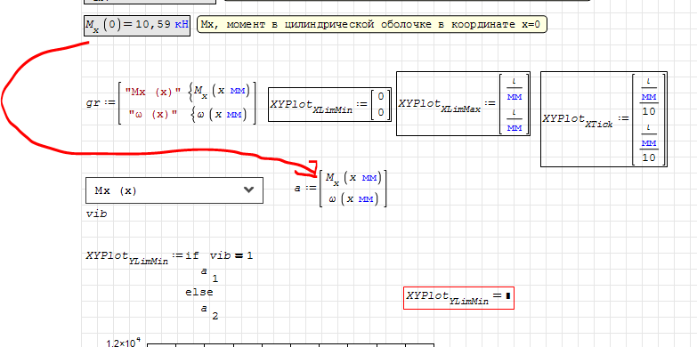

How can I replace it?
on this

Here is your file totally working with units and plotted.
111_examination.sm (38.72 KiB) downloaded 997 time(s).
When I talk about your problem, I guess it is a parse bug of combobox.
Because it can plot normally when function called directly.
And radiobutton and combobox list is not affected if you use like this.
This combobox issue is not limited to XYPlot, 2DPlot is affected too.
When combobox result is directly your symbolic function, it doesn't work.
However, when your function is simplified someway, it can be plotted.
This bug should be examined by author of combobox plugin.

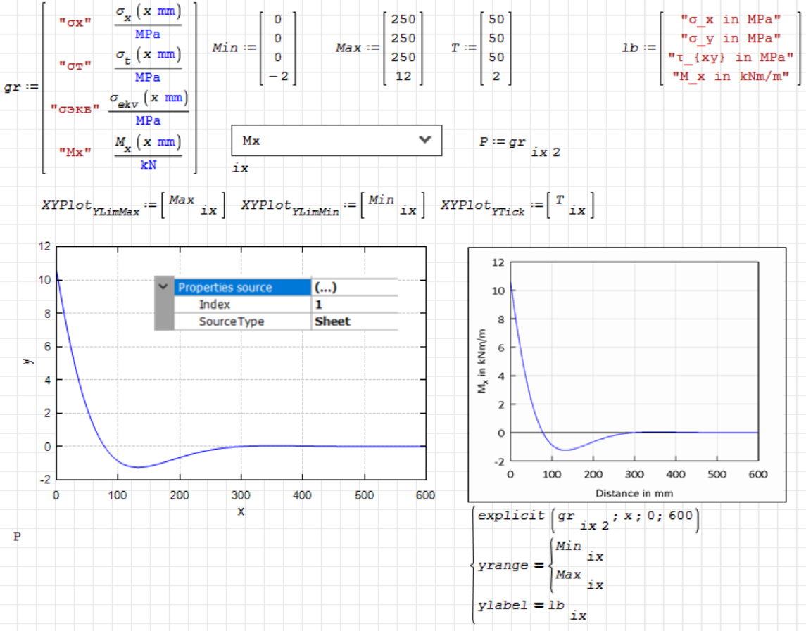

I guess you want to set the limits depending on the selected function.
Let the combobox return the index of the selection and then use it to pick the appropriate values from lists.
In Maxima, you also can set the axes labels and the trace legend text using SMath expressions.

Most of time, eval() or line() is your friend.
This change made your function available to plot.

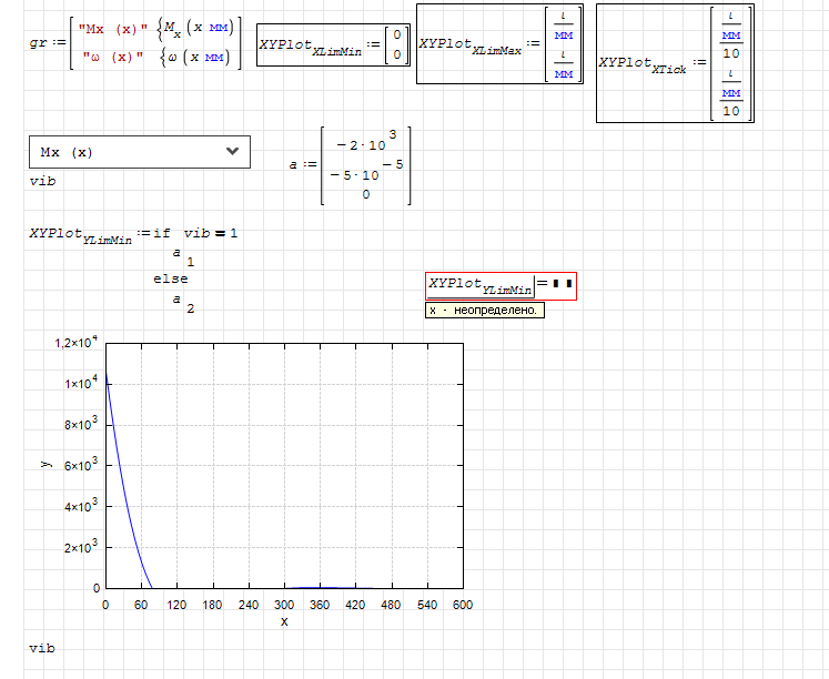

Yes, I would like to substitute values ​​from the results for set the limits

111_Kr2.sm (60.85 KiB) downloaded 948 time(s).

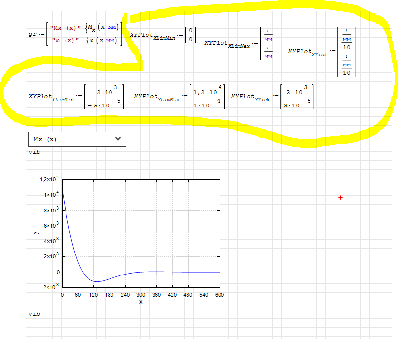

I like the way limits determined by YLimMin, XLimMax, etc.
However, if you rename XYPlot to XYPlots or Plot1 or whatever, this method doesn't work particular plot.
Actually, all XYPlot are affected by XYPlot.option disregarding name of plot.
Is this a bug or a feature?

As far as I understand, you can control multiple plots individually by providing vector values to the XYPlot-variables. In the settings you select select SourceType->PropertyGrid and provide the index to use for accessing the values.
You find an example in the interactive handbook (Plugins->X-Y Plot Region).

Thank you very much! That's what I needed.
The only question is: does SMath have auto-scaling of axes as it was in Mathcad? this would greatly simplify the process)

Использование Properties source - это исторически первый способ управления компонентом из документа, он был оставлен для совместимости со старыми документами.
Автомасштабирование в компоненте XY Plot не реализовано из-за того, что я не нашел удобного алгоритма поведения для комбинации явных и неявных графиков. Для отображения неявного графика область должна быть задана конкретно, а для автомасштабирования наоборот не задана.

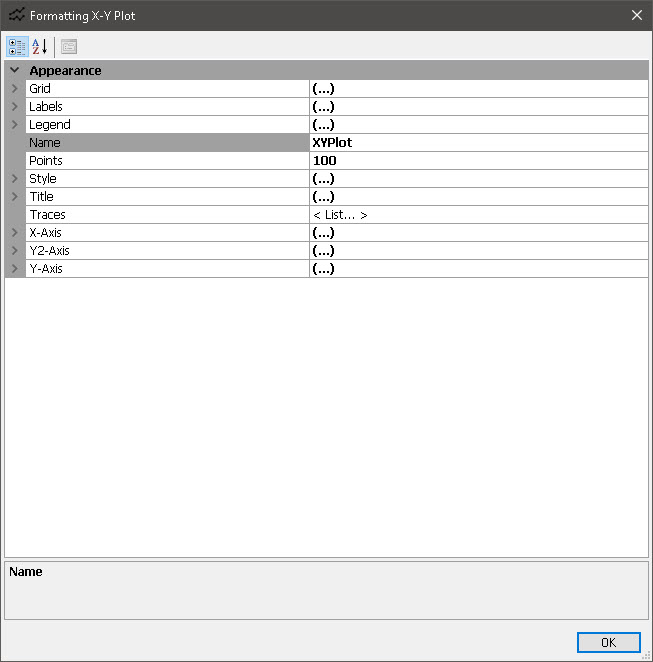

I can add this option to customize the properties
