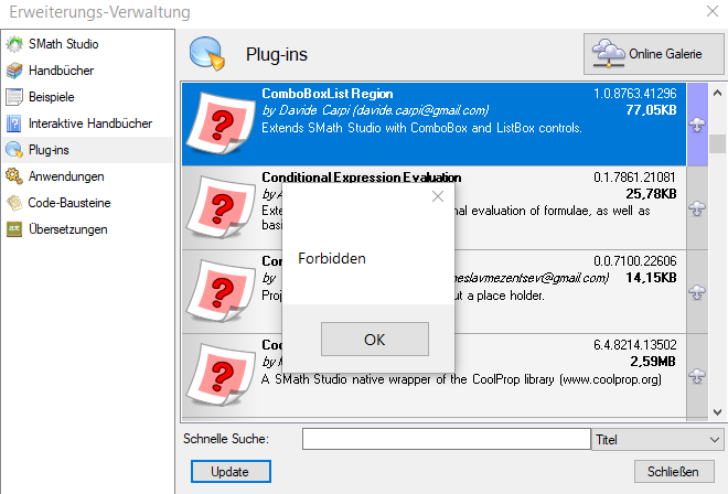

Wrotesince the new Update i can't update or install Plug-ins. Is it because of the basic version i am using or is there on program error ?
Yesterday, I was Solver 30405
Error messages eternized about Maxima not available
Shut the box, restart Smath ... Oh! new version.
Open the dialog box, red down all conditions,
most important down to last line
Accept ... download ... install
All fine ... 30405 is now "1.1.8763.0"
Thank you @overlord. I had to repair the program and now it works.

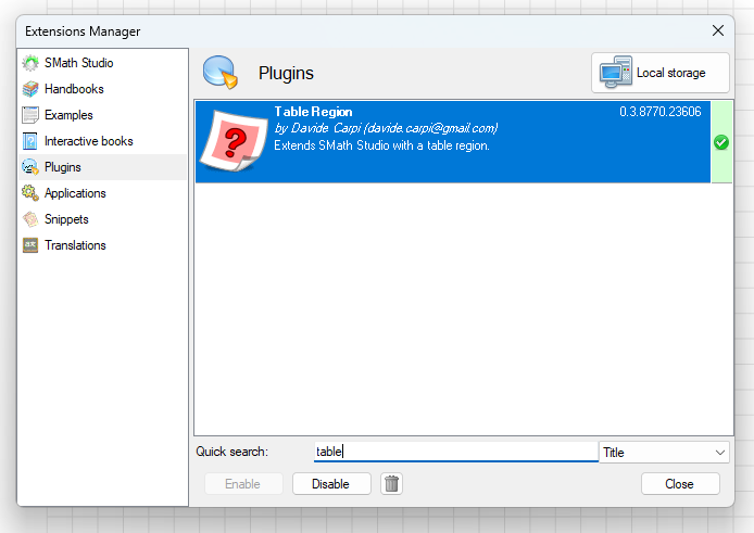

Hello [userlink]Thilo[/userlink]
The plugin should work for everyone in the latest SMath Studio, this is the version that should be listed in your extensions manager.
![2024-01-15 12_05_50-SMath Solver - [Worksheet1].png](/zh-Hans-CN/files/Download/AumrUG/2024-01-15-12_05_50-SMath-Solver---[Worksheet1].png)
WroteBut one plugin (TableRegion) don't work. Does the TableRegion only works in pay-accounts?
