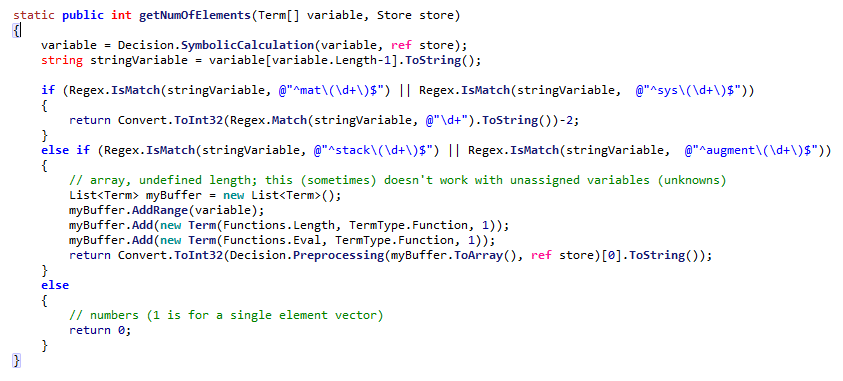

You can try to use/enhance the IsScalar() and IsMatrix() functions of varManager snippet (updated to fix an issue in IsArray(#)).
EDIT: If you are writing a plugin you can use something like the getNumOfElements function in StatisticalTools or NonlinearSolvers plugins
best regards,
w3b5urf3r

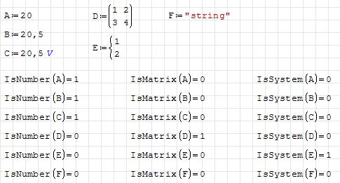

#5 Posted: 2013/1/8 17:37:34
1,435 likes in 2,913 posts.
Hi Infinity
I'm very glad that you came back with a new plugin
Just as a feedback the IsNumber fails evaluating infinity and imaginary unit and there are some issues with single elements arrays/systems
best regards,
w3b5urf3r
