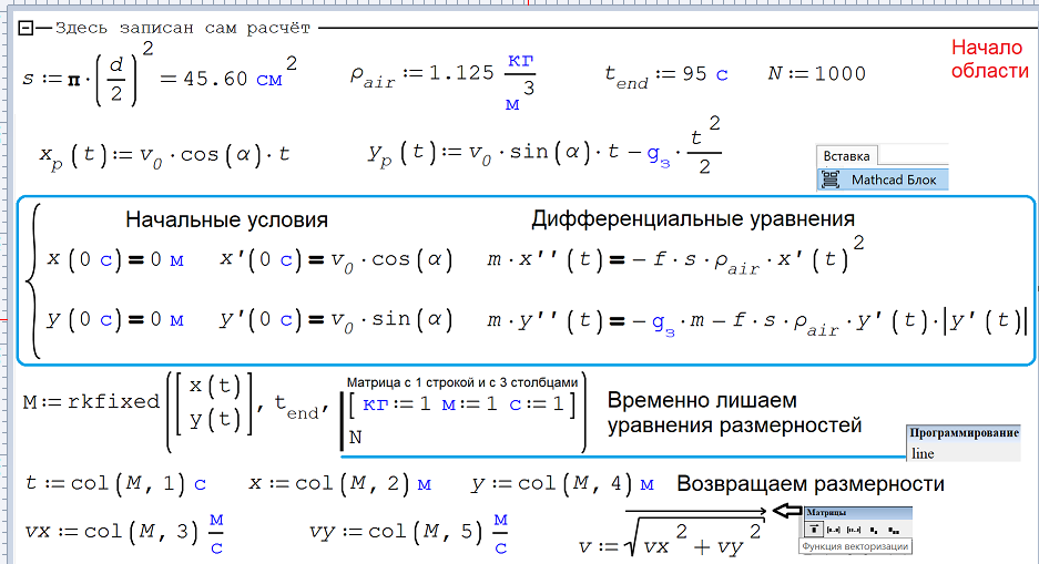

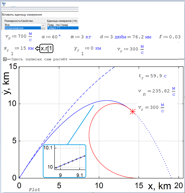

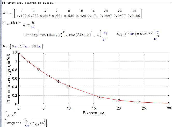

SMath Forum SMath Studio Samples Iron-Dome 1 Pages (2 items) Iron-Dome - Messages Go to last post #1 Posted: 2025/1/28 16:55:36 Valery Ochkov 64 likes in 670 posts. Group: User IronDome.sm (39.7 KiB) downloaded 1000 time(s). 1 users liked this postAndrey Ivashov 2025/1/31 21:09:00 #2 Posted: 2025/1/31 13:51:50 Valery Ochkov 64 likes in 670 posts. Group: User With air resistanceThe article (Russian) Iron-Dome.pdf (642.75 KiB) downloaded 649 time(s).SMath-file IronDome-Air-h.sm (47.53 KiB) downloaded 1023 time(s). 3 users liked this postAndrey Ivashov 2025/1/31 21:09:00, Oscar Campo 2025/1/31 22:23:00, francesco rapuano 2025/2/1 01:56:00 1 Pages (2 items) New Posts No New Posts
