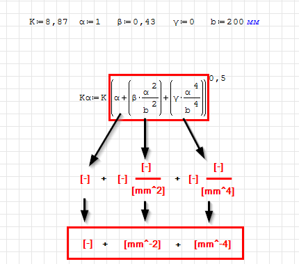

#4 Posted: 2015/2/2 20:11:26
1,443 likes in 2,935 posts.
Maybe the attached picture helps a little bit more to understand the issue...
As stated previously, you can't sum apples and oranges; therefore the error message seems consistent...
