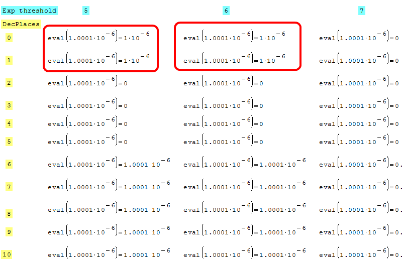

Hi all,
I noticed that the output of the eval() function is related in some way to the decimal places setting... Don't know if it's a bug or a feature, but seem it's not a rule (see the screenshot)
IMHO it's preferable to cancel this behavior...
best regards,
w3b5urf3r
eval.sm (8.69 KiB) downloaded 1335 time(s).

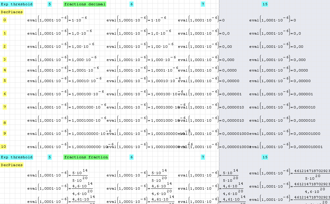

I'm not sure...
eval.sm (44.55 KiB) downloaded 1361 time(s).
#4 Posted: 2013/5/28 09:29:26
Sorry, Davide - I do not get it
And where all those fractions come from. I delete them, press equal to - and got the fixed/exponential numbers
eval-1.sm (44.68 KiB) downloaded 1373 time(s).

Maybe I'm wrong in my first post, but I don't understand from where the values in the red boxes comes
me too... SMath 0.96.4884 on my notebook... o_o

The trouble comes from the fractions setting in the context menu and how it is processed.
If you switch to decimal, then everything is fine. Default setting is "auto". If set to "fraction", then odd fractions are generated, which are far from minimal (or just correct) representations of the given number.
Also, for more clarity, I switched on the display of trailing zeros.
EDIT: line 8 is same as line 7, sorry, but you still get the point...
Davide Carpi 2013/5/29 09:30:00, Radovan Omorjan 2013/5/29 09:58:00
