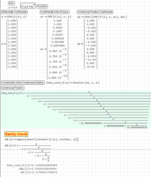

#1 Posted: 2020/2/12 01:04:02
CBG
CBG
78 likes in 312 posts.
Four examples of Continuous Fractions
Continuous_Fractions_SS7251.sm (79.76 KiB) downloaded 1216 time(s).
Continuous_Fractions_SS6179.sm (76.96 KiB) downloaded 1190 time(s).

#2 Posted: 2020/2/12 09:17:10
Four examples of Continued Fractions
Thanks Carlos ... works well.
More from Maple ... Jean
Symbolic Convert Parfrac Primary FNCTS.sm (27.81 KiB) downloaded 1163 time(s).

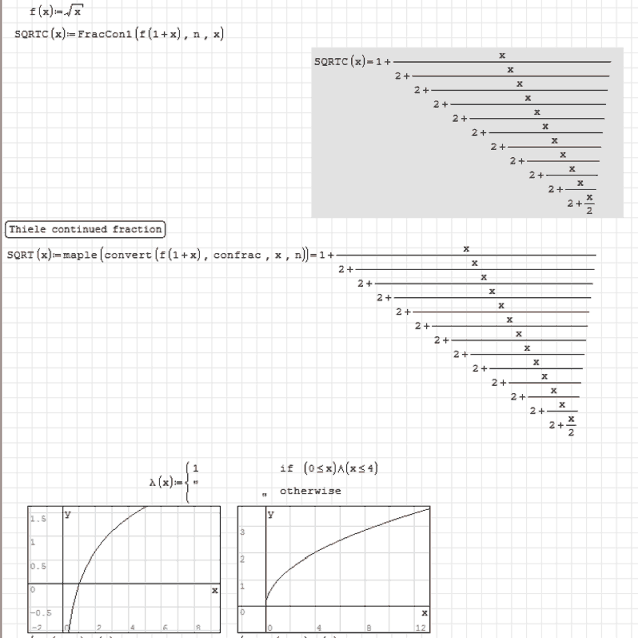

Hola Jean
Thank you very much for your examples, they have helped me to correct
a fault that was presented in the ACOS (X) function, where the value
of "Phi () / 2" was not included.
I have merged all the algorithms in a single function for ease of use.
All the examples you provided work perfectly with the algorithm for
the conversion of function to a continuous function.
SMATH STUDIO VERSION 7251, DOES NOT ACCEPT THE ACOS (X), ASIN (x) AND
ATAN (X) FUNCTIONS FOR MAPLE, GIVING THE "EMPTY STACK" ERROR.

#4 Posted: 2020/2/12 22:31:16
Maybe Viacheslav can doctor the sick Maple.
Few more in there Carlos ... Jean
Symbolic Convert Parfrac Primary FNCTS.sm (101.16 KiB) downloaded 1200 time(s).
