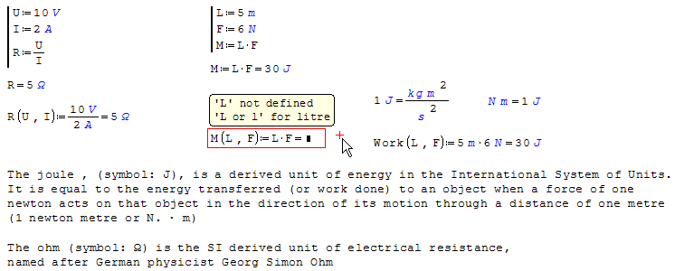

SMath, as I know, have two evaluators: Numeric (=) and Symbolic (Ctrl + .). I guess that what you want is a new evaluator: Substitute for knows (Ctrl + , perhaps)?

What I want is:
1. The formula
2. Substitution of numerical values with units (than can clearly can be seen)
3. Result of numerical values and units (one number, one unit)
as shown above in my initial email.

Jean, thank you for your efforts. You are showing everything one one screen, but try to imagine the following.
Quote
L = 5 m
F = 6 N
M = L x F = 5 m x 6 N = 30 J

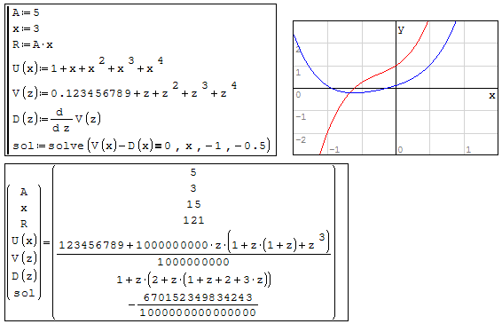

To the wording of your thread "Evaluation of a formula with units"
That is the task of symbolic, that's why the red snippet in my reply.
In Professional works, we define/indentify the contex/units ...
then produce the document(s).
I don't understand your zillions pages long formula.
I don't understand /One page later, /Two pages later,/Three pages later
Attach something: collabs will read .

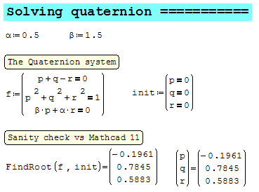

I suggested "user defined expansions" a few years ago there is a link on this post: http://en.smath.info/forum/yaf_postsm6545_Display-values-with-definition.aspx#post6545
Maybe this way could be possible, by having the user configure how an expression has to be expanded?
#11 Posted: 2016/10/27 12:51:36

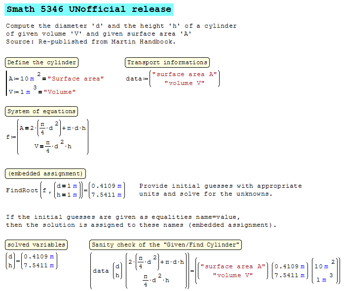

#13 Posted: 2016/10/29 09:24:25
#14 Posted: 2016/10/29 09:31:59
#15 Posted: 2016/10/29 09:55:20
That thread goes nowhere w/o productive demand.
