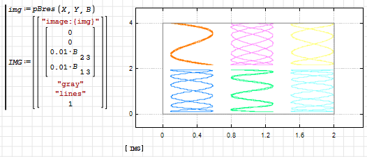

#5 Posted: 2025/1/3 12:21:22
1,123 likes in 1,795 posts.
Second life: now it can be inserted into an XYPlot.
BresenhamPlot v3.sm (72.72 KiB) downloaded 1599 time(s).
BresenhamPlot v3.pdf (320.81 KiB) downloaded 1031 time(s).
