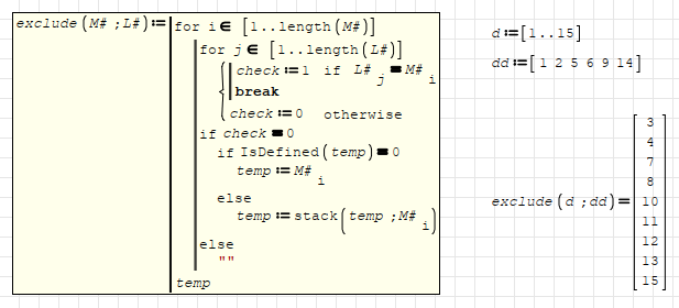

#6 Posted: 2022/1/14 15:06:20
598 likes in 1,380 posts.
In addition to sergio's answer, you can use an custom exclude function.
It will remove substances of a L# list from master M# list.
exclude.sm (5.92 KiB) downloaded 1033 time(s).
