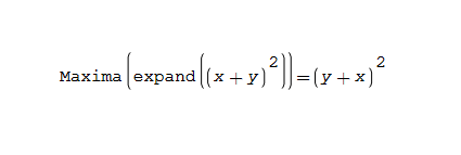

Dose anyone know why using the function expand of maxima dosent work? Thanks
Any example of the problem? Use the paperclip button to attach screenshots.
You have to use the functions correctly and you need to set optimization to None, otherwise SMath messes up the returned expression from Maxima.

WroteYou have to use the functions correctly and you need to set optimization to None, otherwise SMath messes up the returned expression from Maxima.
