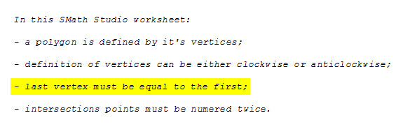

#7 Posted: 2019/7/1 05:29:57
1,435 likes in 2,913 posts.
Does it work as well for open polygon ?
Nope, this worksheet was made just for closed polygons.
