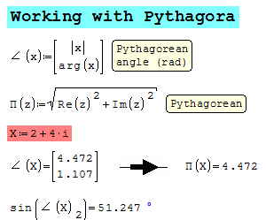

... more maths for your Pythagora [Area, Perimeter].
Maths Polygon Edu.sm (47.22 KiB) downloaded 601 time(s).
Maths Polygon Area_Perimeter.sm (55.37 KiB) downloaded 591 time(s).
Maths Polygon.sm (860.25 KiB) downloaded 583 time(s).
#12 Posted: 2020/3/4 12:08:49
ATOMATIC rather than semi-automatic sketching.
Solving all Pythagora ...
Maths Pythagora.sm (16.29 KiB) downloaded 589 time(s).
