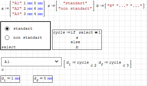

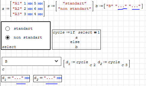

Hello. I use this for outputting data if/else. If the data is already entered in the matrix, then everything is fine. How can you get manual data entry instead of "..." with this choice? What do you need to replace the matrix "b" for this?
#2 Posted: 2022/8/17 14:07:27
26 likes in 155 posts.
I think I understood what you are trying to do. Take a look at this example.
data_output.sm (9.15 KiB) downloaded 1207 time(s).
There is also a couple way to handle the input depending on if you work with SMath solver worksheets or with SMath Viewer EXE files.

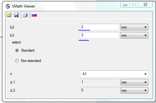

Thanks, this is a good way for me. (I came up with method: inserted it instead of empty elements 0, and then the cycle if/else a or b.)
I'm trying to work with SMath Viewer EXE files.
Such a question appeared: How to replace b2 and b3 on 0, if selected "standard"?
#4 Posted: 2022/8/18 18:39:51
As far as I understand there is no way to modify the values in the data input fields. Only by manually changing them yourself.
