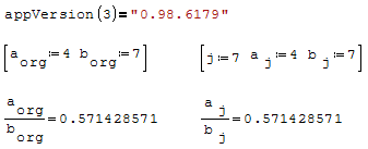

If I enter following operation:
a.org := 4
b.org := 7
r := b.org/a.org =
After entering "=" Smath hangs up.
"org" is a subscript.
I deinstalled Build 7089 and installed Build 7030. The bug disappeared.

I cannot reproduce. Anyone else noticed it?

As for Davide, I can't confirm. The operation runs correctly on my Win7 professional PC and with the latest version of Smath "0.99.7089.34082"

No such problem with latest "0.99.7089.34082", in my Win 10x64 bit Home Ed.
In fact, it runs smoothly with most of my previous programs.
Still testing the balance.
