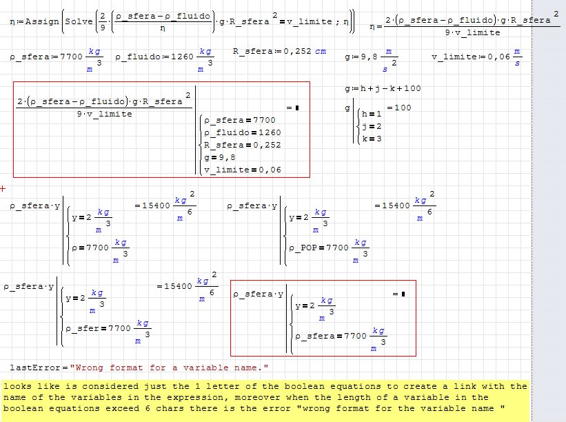

Hi Davide,
I am trying to use the at(2) to try to evaluate a formula with several variables in one step.
OK this makes quite no sense ...but is in an attempt much more difficult to use a same symbolical equation obtained through a solve in different parts of a documents with different values of the variables without using each time the technique of the disable evaluation ( at least is the only way I have found to address this issue ... it doesn't exist a command that allow to reuse a symbolical equation after some assignment have been done to the values of the variables referenced in it ).
However in doing this I have seen a strange behaviour of the at(2) as herewith reported:
See my comments in the screenshot.
Franco
#90 Posted: 2016/12/3 14:39:56
1,443 likes in 2,935 posts.
Hi Franco
Once the variables are unknown at the definition of eta, you can reuse it any times you need, just define again the variables' values (search it in the Dynamic Assistant, you see that no numeric values are stored); use Clear(...) if you need to show again the unknown names.

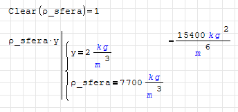

This is because in the second argument of at() you are using variables already defined, therefore at() reads "7700*'kg/{'m^3}≡7700*'kg/{'m^3}" instead of "ρ_sfera≡7700*'kg/{'m^3}" -> currently you have to use Clear(ρ_sfera); I plan to improve at() with progressive preprocessing, to reduce these kind of problems (and the error message too).
sergio 2016/12/3 16:32:00

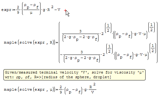

If you set your formula "mathematically"
[in this case as an implicit expression],
you will solve anywhere in the document
for any of the variable.
#92 Posted: 2016/12/4 09:30:10
frapuano
frapuano
13 likes in 115 posts.
The problem Joan was not to get a formula using the solve command but use the result of the solve in several places on a worksheet ( always the same equation obviously ) as happens in a book when you are explaining something using always the same expression but applying different values on the RHS variables.
I was worried that after using the 1st time an expression it was no more "live" for further usage with different values.
This till the explanation of Davide I was using the trick of the "Disable evaluation" ..but this is not very elegant and useful.
( to tell the truth I have used the clear ..but probably positioning it in an incorrect way because the result was not like the one shown by Davide )
Franco

In mathematics, there is solving & solving. Smath is generous
by itself and in Maple companionship, quite convenient for
teaching/publishing/engineering.
Visit some "solving" applications attached. Report what does
work or not clear.
Solve Maple Implict Expr.sm (48.7 KiB) downloaded 1423 time(s).
frapuano 2016/12/6 06:56:00

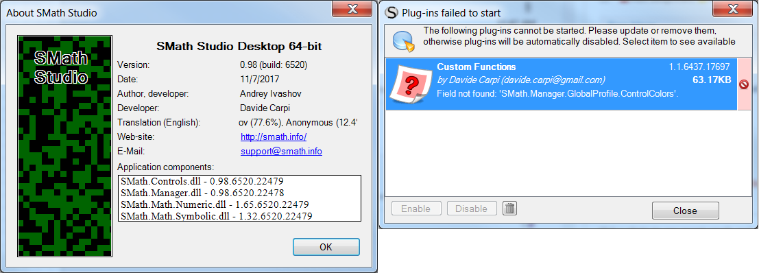

Alexander O. Melnik
Alexander O. Melnik
127 likes in 498 posts.
Hi Davide, ran across this error...
