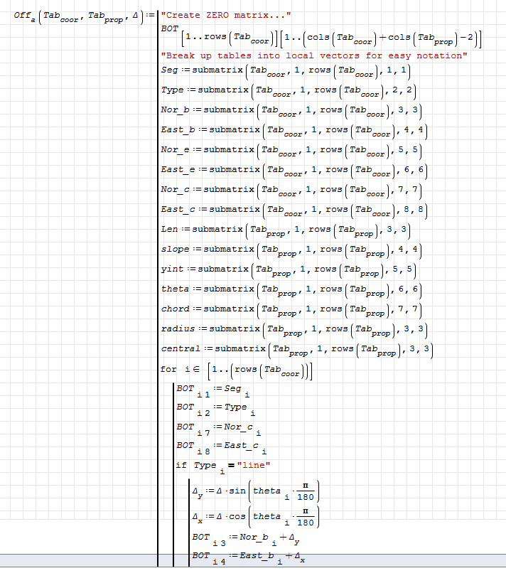

I am just working with some data table (matrix) calculation and manipulation. And, though simple, the functions / routines that I have come up with are rather long and can extend over the page breaks, which is making portions of them difficult or impossible to see.
My hope was that if I could break the longer function into a few smaller functions, then I could control the page break locations, as well as make the local equations more user-friendly (for checking) by having the local variables (and their values) pass from one embedded function to the next.
But I don't think the local variables will pass between the functions that way. :*(

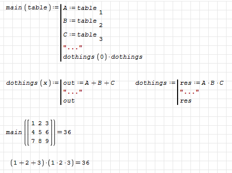

function3 (x) = function2 (function1 (x))
Off_b = Off_a (names (table1, table2, value)) in the attached worksheet

However anything defined at some point is available at the same level and on deeper levels, thus you can make all more compact/readable by calling one or more functions after defining you data.
