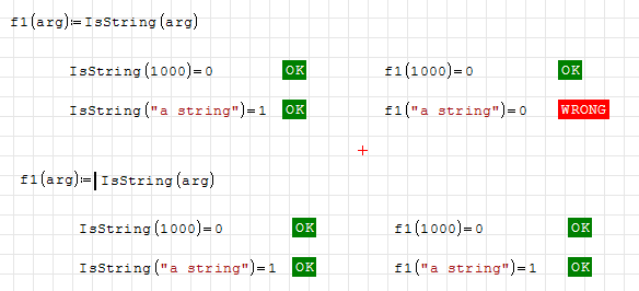

I found this bug defining user functions with IsString()
The issue disappear using IsString inside line()
regards,
w3b5urf3r

#3 Posted: 2012/7/29 14:55:10
2,340 likes in 4,041 posts.
Thank you! Fixed.
Regards.
