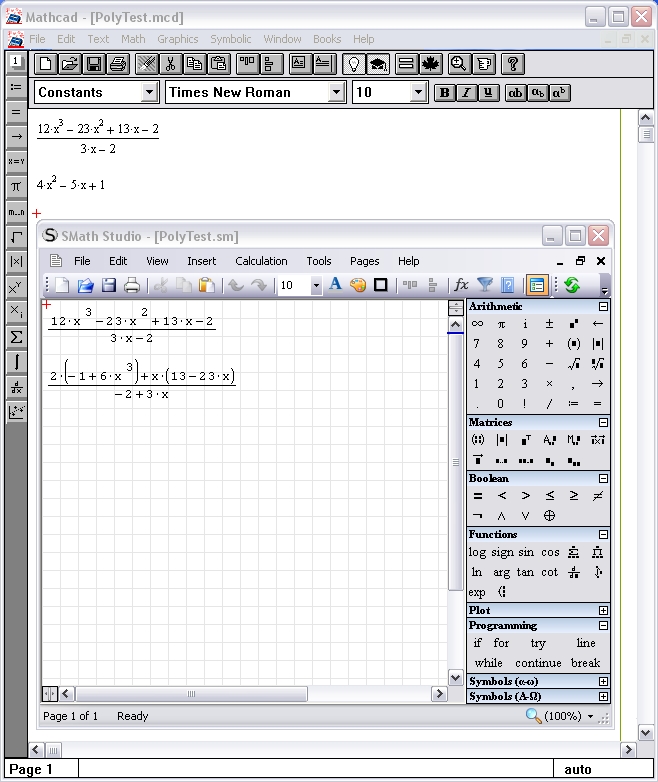

However, what brings me to the forum is best encapsulated with the following screenshot from my Windows machine while running both MCAD and SMath on the same polynomial division problem:
As you can see, MathCad 4 gets it together when calling "simplify"; and SMath, though 24 years newer, seems to miss the point wholeheartedly during the same operation. As a quick threshold criteria, I'm looking for a robust, concise output to ply when challenged with the basic task of polynomial long division.
So here's my question: Are there any plugins/configurations which can make this happen with SMath as expected?

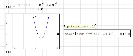

#2 Posted: 2017/4/25 22:22:39
Sure: the Smath symbolic engine is 'maple' ... not completely coded
but works great for most current needs, example Laplace stuff.
Same as Mathcad: after the maple expression Ctrl+. for the symbolic expansion.
Poly Test.sm (160.99 KiB) downloaded 1075 time(s).
maple() - just a function from the plugin. SMath Studio has its own symbolic engine.
