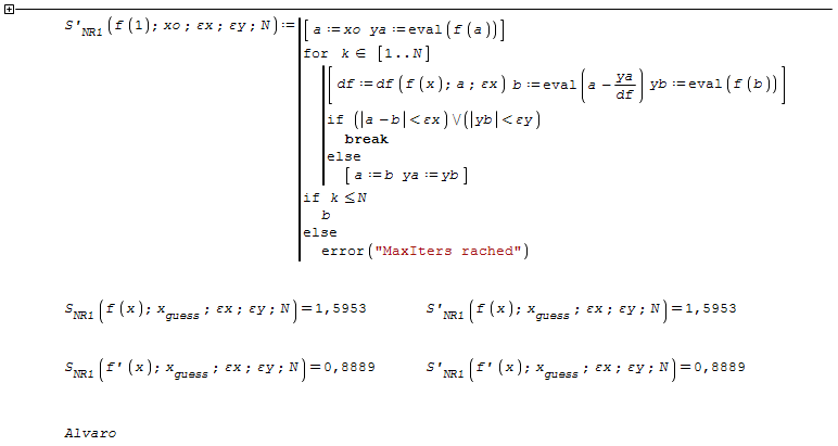

Hi. I can't call a function which uses a call for functions too. How to solve that? Example in the attached.
function_1v.sm (17.56 KiB) downloaded 1194 time(s).

I guess f(a) isn't recognized as a function in the call df(f(a)...) as f(a) evaluates to a number, not a function. Use df(f(x)... instead, with x being something undefined.
Alvaro 2019/4/2 10:14:00
#3 Posted: 2019/4/2 10:13:54
1,123 likes in 1,795 posts.
Hi Martin. You're right! Thanks.
