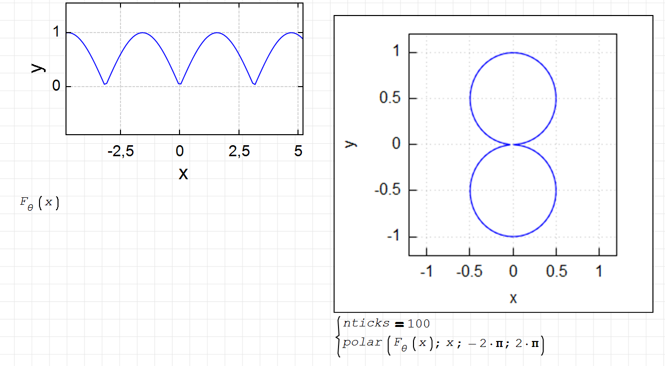

#2 Posted: 2021/10/18 08:49:34
1,355 likes in 2,271 posts.
You can use the Maxima Draw2D region. Sorry for the high resolution screenshot, this seems to be a new feature of the smath solver or some other dpi glitch on my system (the screen was not high dpi where the shot was taken from, however).
Herzt_Dipole_Polarediagram_Kr.sm (473.09 KiB) downloaded 1204 time(s).

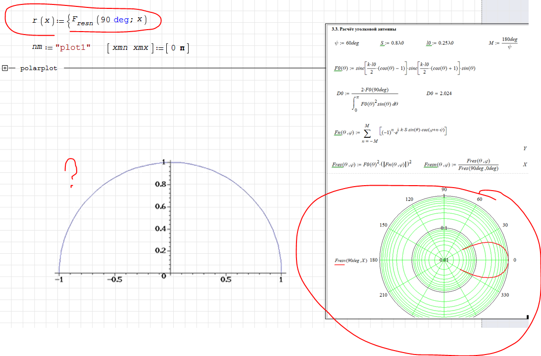

Hello Smath users,
do you have experience or any idea, who to create a polar plot like Mathcad, as shown on the picture?
I need a dB or Log - scale for radius and marking of directions
Thank you for you help.
Best regards,
Andrey

Hello Smath users,
Best regards,
Andrey
I remember Viacheslav has introduced a polarplot example with maple plugin.
Maybe that demonstration can be a starting point for you.

Dear SMath users and developers,
unfortunately I did not succeed to create the graph as polar diagram with the help of Maple plugin.
I have tried different options, with Maxima plugin it works, with Maple unfortunately not.
Just one thing. How can I create the polar lines and circular lines (dB or Log20 or Log10) with different step sizes?
A desirable is the one polar diagram as on the picture Calculation of the corner antenna.sm (423.36 KiB) downloaded 1125 time(s).
That is unfortunately a pity that there is not available a Polar-Diagram set s a normal tool or plugin.
Best regards,
Andrey

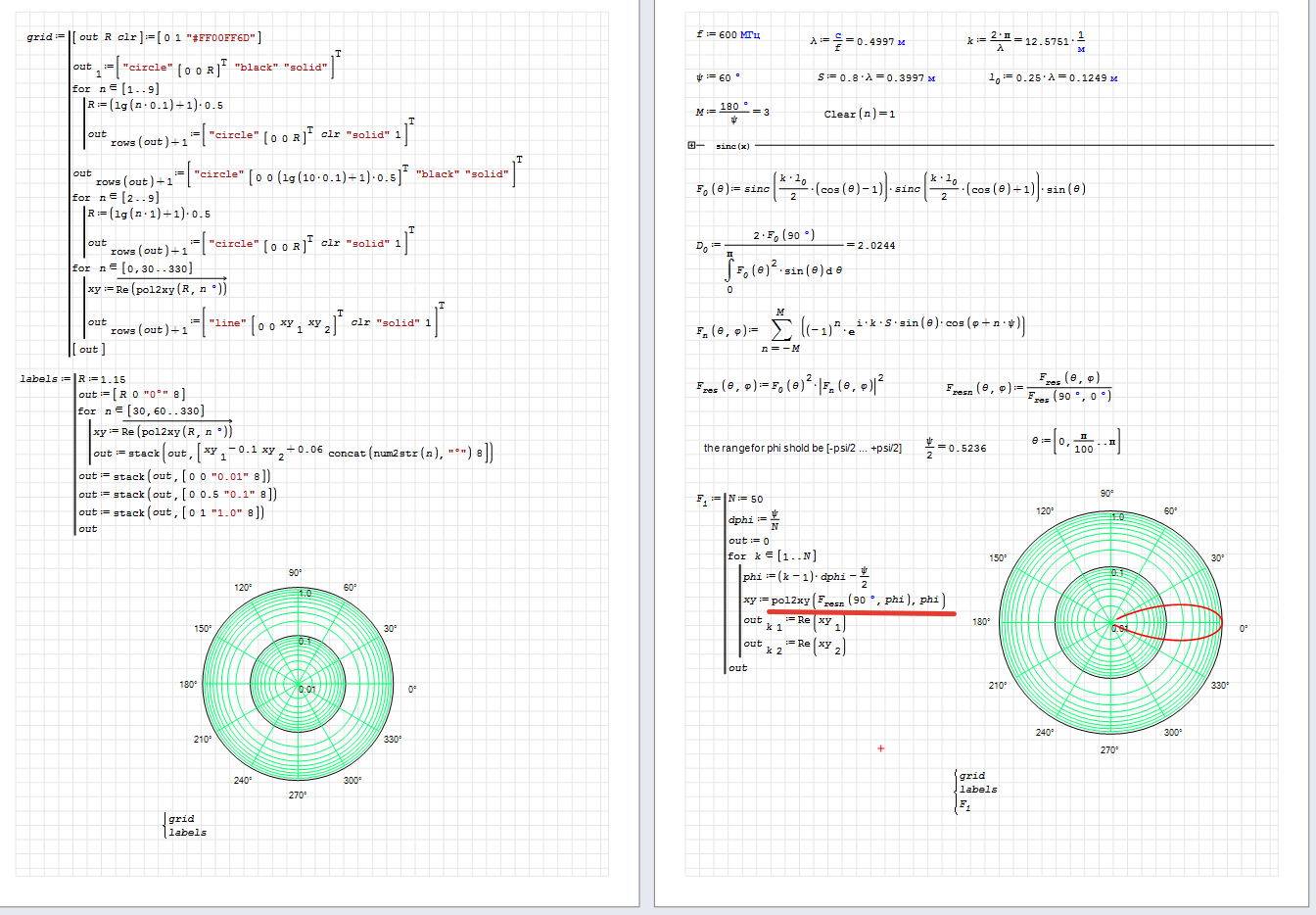

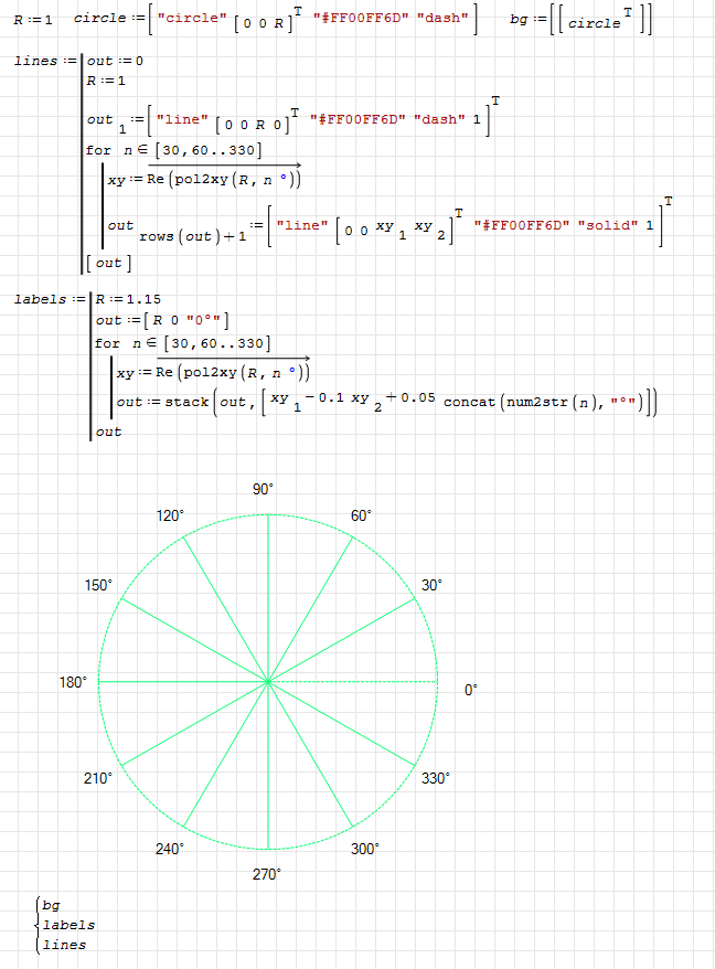

#8 Posted: 2021/11/16 07:05:21
1,554 likes in 1,864 posts.
You can use X-Y Plot for this. The function must be drawn with a coordinate transformation in the form of a matrix.
XYPlot. Shapes. Polar grid.sm (11.58 KiB) downloaded 1131 time(s).
XYPlot. Draw shapes.sm (19.85 KiB) downloaded 2965 time(s).
XYPlot. Draw shapes.pdf (92.91 KiB) downloaded 2003 time(s).
#9 Posted: 2021/11/16 09:11:53
Something like this, but you need to display the logarithm of the curve.
XYPlot. Shapes. Polar grid.sm (34.66 KiB) downloaded 1120 time(s).
#10 Posted: 2021/11/16 09:31:30
Such conversions are fine, but I'm not sure if they are correct.

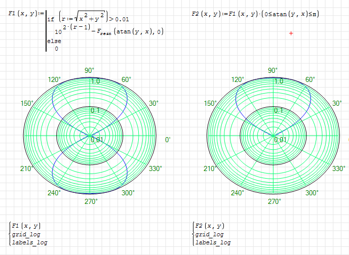

#15 Posted: 2021/11/21 19:59:03
Можно так.
File not found. File not found. File not found.
#16 Posted: 2021/11/23 05:15:51
Andrey
Andrey
1 likes in 44 posts.
Вячеслав, cпасибо, вы мне очень помогли.
С уважением,
Андрей
#17 Posted: 2021/11/23 13:19:11
1,123 likes in 1,795 posts.
Можно так.

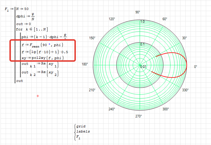

There is there a very mysterious r> 0.01. My explanation is that, first of all, you have to make sure that the argument for log10 is positive, but then you have to verify that in the polar graph it is f> 0, because in polar coordinates only positive values of the position vector module are considered. This implies that f = 0.5 * log10 (r) +1> 0 is needed, from which solving for r we have the mysterious condition r> 0.01.
Addendum:
The original range for the graph is 0 < theta < 180º . Outside of that domain the problem is not defined, or simply does not matter. Viacheslav restricted the domain by imposing y> 0, which is correct, but the following form shows a little more clearly how the transformation of coordinates from Cartesian to logarithmic polar is done, and then imposing the original condition on the domain, so that XY plot just plot in the desired range.
