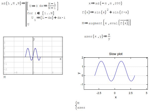

I installed Smath Studio from the AUR repository, I am using Arch and the installation went fine.
I am reading the document GraficasBasicas2012.pdf, which I downloaded from the Wiki Tutorials.
The problem is that the function augment(1,2,3) works different under Linux, and I cannot figure out how to make a simple graphic as the one in the adjointed file.
graficos_prueba.sm (9.46 KiB) downloaded 887 time(s).
Maybe someone could help me, regards.

In the Tools->Options Section I could change the semicolon <;> and now I use the comma (,) as separator. Now I can use the function augment with comma (,) but the graphic function is still not working.
I wonder whether someone can give me a hint.

Hi Jean,
I can reproduce your example without any problem, I cannot understand where the parameters H,N and L are defined. Also, you defined a function xd and used to evaluate x. Why I cannot use range?.
I suppose that is there an useful explanation for this, which I am curious about it. Maybe, you can give me some hint?
#7 Posted: 2023/3/30 13:09:12
Hi Jean,
[L,H,N] are defined in x:= xd(L,H,N)
Why I cannot use range ?.
If you use range, 'x' will start -pi
but will never exactly terminate +pi
unless N in range is 15 decimals ... totally foolish.
Your graph does not terminate +pi.
xd discretizer will populate exactly any 'N' ± pi.
Cheers ... Jean.

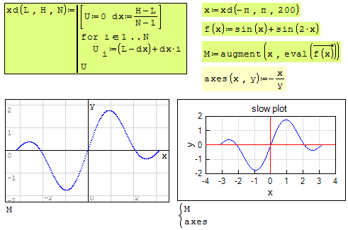

#8 Posted: 2023/3/30 15:28:21
... complete algo style, one of my preferred.
Javier.sm (10.69 KiB) downloaded 871 time(s).

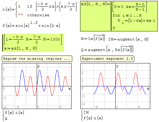

The all thing is to complete a project, mostly export.
See the missing regions ...
Please, don't hesitate ... Jean.
Javier More.sm (9.5 KiB) downloaded 907 time(s).

Hi Jean,
This file is showing the origin of some missing parameters, like H,L,N, thank you for this worksheet.
I have a BSc in chemical engineering and a PhD in Industrial Chemistry, I also work in a biotechnology institute since 2003.
Maybe, this is why I was asking so many questions.
Kind regards,
#14 Posted: 2023/3/31 20:27:42
You are not used yet to Smath algorithmic construction
Eager to assist your ChemEng projects.
