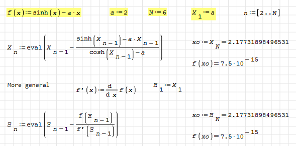

Hi ioan. If we understand 'analytical expression' as 'closed form', the answer is that there is none. But if the objective is to find the real solution, with as many digits as the precision of the calculator used, then it is enough to remember that real numbers are introduced to be able to calculate limits, so this would be a valid answer.
nr-example.sm (9.37 KiB) downloaded 805 time(s).

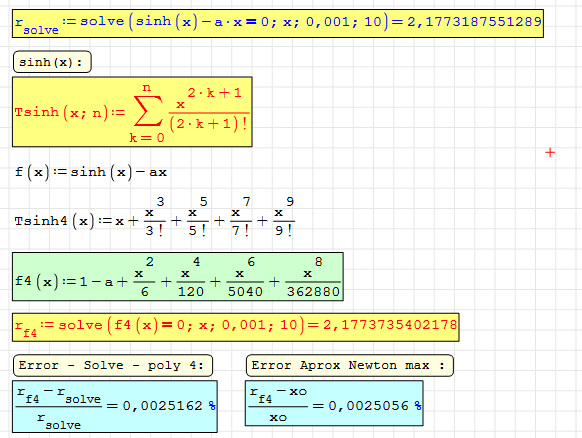

4. In the SMath environment there also is a compact, numerical solution based on the "solve" command (see the annexed file).
Thanks again for your kind attention.

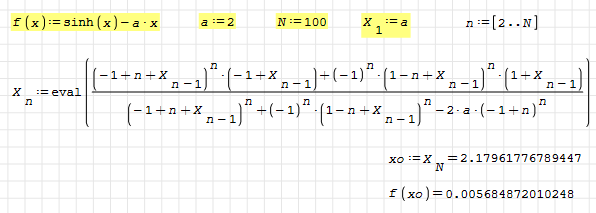

Hi ioan.
Here the root is expressed as the limit of a recurrent sequence as well, but in terms of basic operations.
nr-example 2.sm (14.52 KiB) downloaded 804 time(s).

This last solution seems resulting with a more modest convergence.

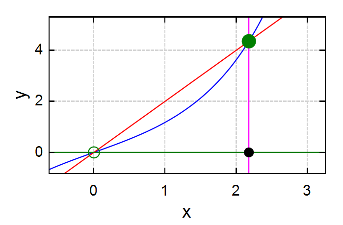

The graphical image of the case is:
It seems that the 4th degree polynom decomposition of the equation, solved without any iteration is enough reasonable; of course, less compact than the solution based on the solve function
Best regards,
Ioan

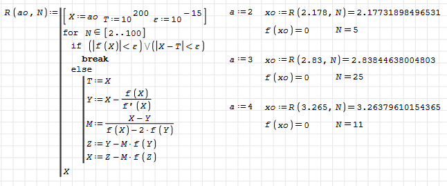

Hi ioan. Dichotomy is always better because it provides an interval of the solution. Here, some other notes:
You're right: the start value is part of the solution, and it requires better attention. This version uses different guess values.
This other is an Improved Ostrowskiroot-finding method, by Miquel Grau & Jose Luis Diaz-Barrero
nr-example 3.sm (19.28 KiB) downloaded 768 time(s).
