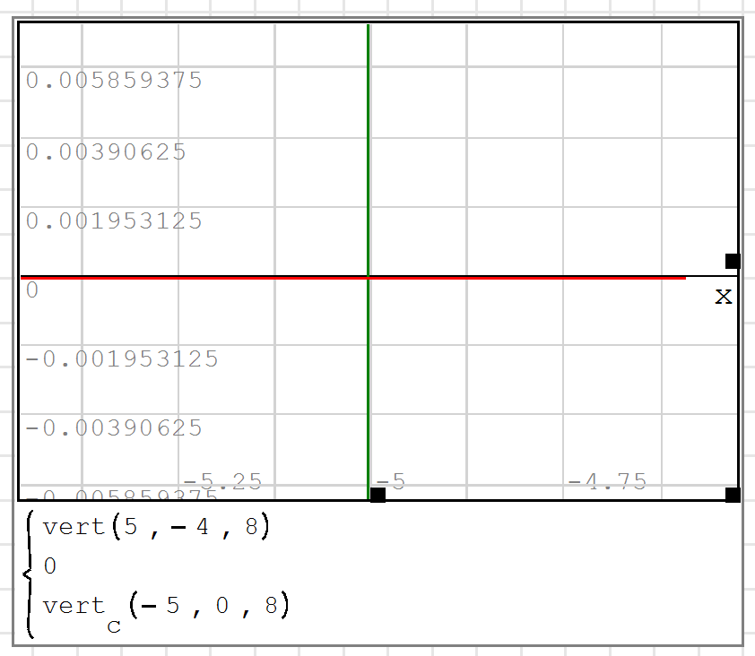

This demonstration (functions inspired by Jean) shows the problem:
С уважением, Михаил Каганский

I assume you are using plot 2D.
Yes, you are quite right. Sorry for being forgetful - off-by-1.sm (5.53 KiB) downloaded 1206 time(s).
Mike, in lieu of screen shot, usse appVersion
Thanks again! I still hasn't quite got used to this new handy feature.
Mike, how did you zoom in?
Entered the graph, then used Ctrl+Wheel (vertical zoom) / Shift+Wheel (horizontal zoom) while keeping mouse over the graph.

It's a zoom graphics issue. If you zoom into the axis, the "Line" is right over the grid line
I just redid an old Gateway laptop ... Linux Mint 17.3 and Windows Vista 32 bit. Your file and my file are identical in the graphics ... when I zoom in, the "line" is clearly over the grid. Look at the zoomed in graph 2D Graph.smz (3.11 KiB) downloaded 1226 time(s).
BTW, thanks for showing me that the descriptor can be moved. Still figuring out how to do it right as I did it by double clicking on the right edge. Sometimes it goes to the right, others to the left ...
#5 Posted: 2016/4/10 00:31:07
Mike Kaganski
Mike Kaganski
184 likes in 434 posts.
No, looking at zoomed graph, and enlarging screenshot, I still see the offset.
... the descriptor can be moved. Still figuring out how to do it right as I did it by double clicking on the right edge. Sometimes it goes to the right, others to the left ...
When you enter the descriptor, it shows three vertical dots to the left. You may grab these and move horisontally.

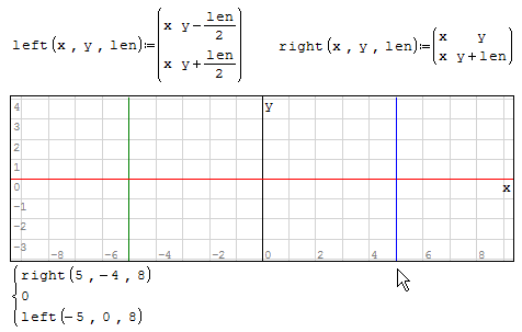

#6 Posted: 2016/4/10 01:41:13
Thanks Mike for the two little modules [saved].
If Smath canvas and screen display dont coincide, there is
at max +/- one pixel OFF. In Mathcad +/- ½ pica OFF.
Trust me, I checked: no pixel OFF in this demo. The OFF
pixel also appears on horizontal grid for same reason,
two flutes playing +/- ½ tune off each other.
#7 Posted: 2016/4/10 09:49:04
... explain more about the image vertical lines:
The image was not properly stretched, 123 pixels for 5 intervals.
Now, stretches back [very delicate] down to 120 pixels, then the maths
120/5 = 24 ... 4*24 = 96
A Windows screen is 96 ppi [pixels per inch], both Smath canvas and
Windows screen do coincide 1/1 and the vertical lines seat exactly
on the top of the grid lines. Years ago, there was an IBM PC 105 ppi.
The IPAD is/was 250 ppi, thus looking so nice. The IPHONE is/was 350 ppi.
Check that to update your knowledge and look "savant" to your friends.
Not beeing so minutious, there may be +/- [1] pixel OFF.
I have no idea about the screen resolution in medical/dentistry, >> 96 ppi.
The resolution of the human eye is normalised 1200 ppi.
Hi PRO cameras may have several times the human eye resolution. What counts
when purchasing camera is the resolution, not the monster pixels. None of
the low cost camera mention "ppi". Years years ago my sister had the most
perfect photo in the world or at least one of the best, from Russia.
All that matters when it comes to HD TV. Only recent documentaries photos
can fill the screen TV. Most of that commercial stuff is BS [bull shit].
Otherwise, extrapolated pixels are invented pixels, can't create what does
exist, do you ?
I was talking about the "zoom in" to the grid/line that shows the "Pixel delta" Capture.PNG. The CRTL+Wheel just changes the scale on the graph.
2D Graph.sm (7.64 KiB) downloaded 1176 time(s).
Looks like it depends on the computer ...My work computer shows the offset
Stand corrected:
The image was not properly stretched,...Jean
I stretched my zoomed in graph to the right ... the "pixilation" went away. This explains why my full graph did not show the pixilation issue ...
Jean, Thank you for explaining what was going on.
#9 Posted: 2016/4/11 10:07:38
Mike Kaganski
Mike Kaganski
Oh, sorry, I misunderstood you. English isn't my native tongue, you know.
Actually, I just used Paint.Net to zoom in, then made another printscreen and combined. A bit of magic

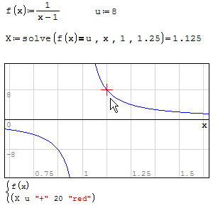

I think this would be a second example. I've tried to stretch and zoom in as feasible.Graphics off.sm (3.96 KiB) downloaded 1155 time(s).
From what I can tell, the error is in the "arrow" size ("20" )[Change the arrow to an x and it shows the same error]. If I make it 1, it appears to hit the right number. This would need to be fixed as it "shows" the wrong location.
The only way to make it "look" correct, so far, is to use a "+" sign.

Anyone else seeing this issue?
#13 Posted: 2016/4/13 11:15:57
There is no issue in there, just plotting coincidence wrt graphic package.
Coincidence that appears in any system. The only symbols that will "center"
on a plot trace are:
(X,Y,".",size,"color")
(X,Y,"o",size,"color")
(X,Y,"+",size,"color")
Davide Carpi 2016/4/13 14:04:00
#14 Posted: 2016/4/13 11:57:36
... in your example, @ 'u = 8' the solution is exact.
As long as in any way you stretche the graph canvas
and the grid 1.125 is present:
the triplet trace/XY grid/symbol will coincide.

Being able to do the "arrow" or the "less than" symbol would have been nice.
#16 Posted: 2016/4/13 14:06:25
1,443 likes in 2,935 posts.
Correct; also, you can use "*" and "x" (wiki: https://smath.com/wiki/Graphs.ashx#SpecialPlots)
Quote
  • Special characters (case sensitive) have position fixed on center on the given coordinates: + . * o x;
  • Words, phrases or non-special characters have top-left corner of (virtual) textbox fixed on the given coordinates;
ElSid 2016/4/13 15:22:00
#17 Posted: 2016/4/13 15:23:18
Ruben Sidranski
Ruben Sidranski
17 likes in 465 posts.
I missed this
Quote
#18 Posted: 2016/4/13 21:00:36
Too many gadgets is like not enough. Make a nice arrow in Paint, slide the plot over the arrow.
