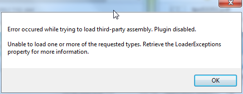

SMath Forum SMath Studio Bugs & Problems Export to Excel does not work 1 Pages (3 items) Export to Excel does not work - ExcelCollab.dll Plug-in error in Windows 7 Smath 0.95.4594 - Messages Go to last post #1 Posted: 2012/7/31 10:57:19 Rob 0 likes in 8 posts. Group: User Hi,I placed ExcelCollab.dll in C:\Program Files\SMath\SMath Studio\plugins and received the following error:Error occurred while trying to load third-party assembly. exportcell was not available.I am using Version 0.95.4594 on Windows 7. Would you assist.Rob #2 Posted: 2012/7/31 16:44:42 Andrey Ivashov 2,315 likes in 3,949 posts. Group: Super Administrator I've recompiled plugin. Please try it. ExcelCollab.zip (51.26 KiB) downloaded 269 time(s). #3 Posted: 2012/8/1 14:57:34 Rob 0 likes in 8 posts. Group: User Thank you for promptly looking into this issue.The re-compiled file was read into Smath! And I see the commands importCell and exportCell!I am trying to reproduce the examples in the Collaboration with Excel post but need more time.Rob 1 Pages (3 items) New Posts No New Posts
