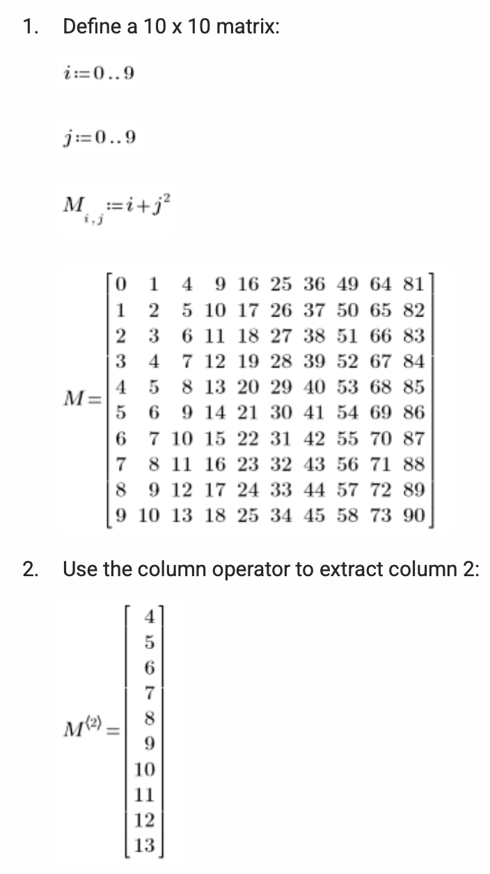

Hi everyone, is there a way to implement mathcad column index operator in smath?
Edited 2025/8/3 08:59:35

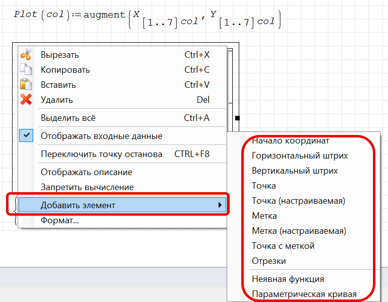

You can use ranges in indexes.
Some examples are built into the component itself. They are needed for self-training of the user.

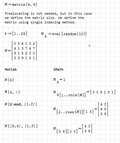

Hi. I think matrix indexing in SMath is more convenient to think of in terms of its Matlab analogy, rather than Mathcad.
Matlab-SMath.sm (9.14 KiB) downloaded 1248 time(s).
For value assignment, the left-hand indices must be assigned variables or constants; that is, they cannot be constructed in the subscript.
