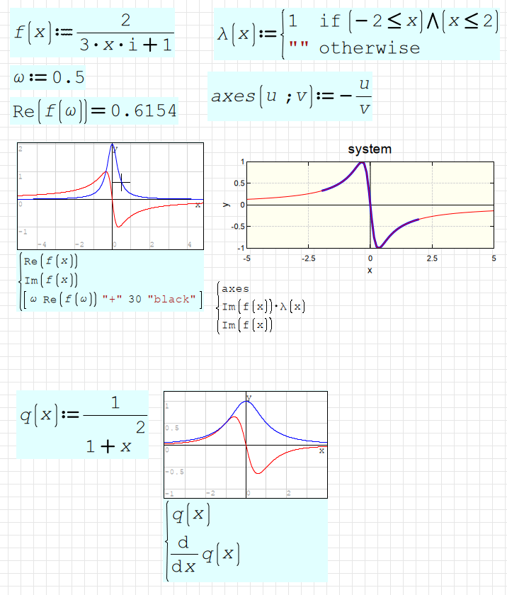

#1 Posted: 2024/2/12 20:49:16
Valery Ochkov

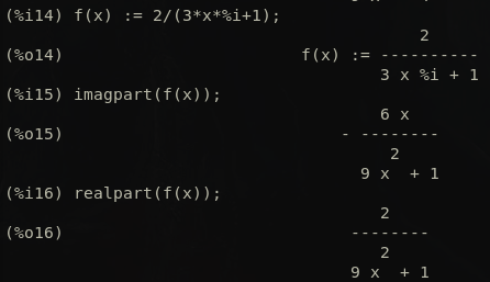

#2 Posted: 2024/2/12 22:44:45
580 likes in 1,348 posts.
Natively, I don't know how it can be done.
Possibly you can't because smath symbolic engine is inferior.
Maxima can solve it. I assume maxima plugin can solve too in smath.
Maple plugin couldn't solve, maybe there is a trick I don't know.
#3 Posted: 2024/2/13 01:33:37
As suggested ... remembering Imaginary is the Derivative
Worksheet104.sm (9.66 KiB) downloaded 904 time(s). ... Please, let me know if working ... Jean
#4 Posted: 2024/2/13 02:14:07
If anything you posted is related with question,
If any of your replies contains tiny bit fraction of correct answer,
It would be a miracle.
NO, IT IS NOT WORKING BECAUSE IT IS JUST A PLOT.
This is what Jean posted!!!

#5 Posted: 2024/2/13 03:58:14
1,308 likes in 2,221 posts.
Maybe, Re() and Im() are worth adding to MaximaTakeover? Yet wrapping in Maxima() does the trick for now.
ReIm.sm (3.95 KiB) downloaded 866 time(s).
