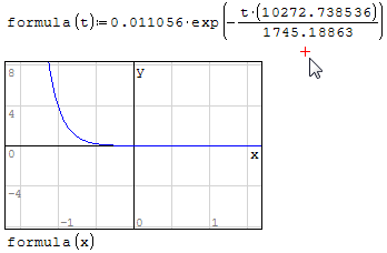

#5 Posted: 2019/4/25 11:02:17
Have you got the same ? easy to sanity check.
