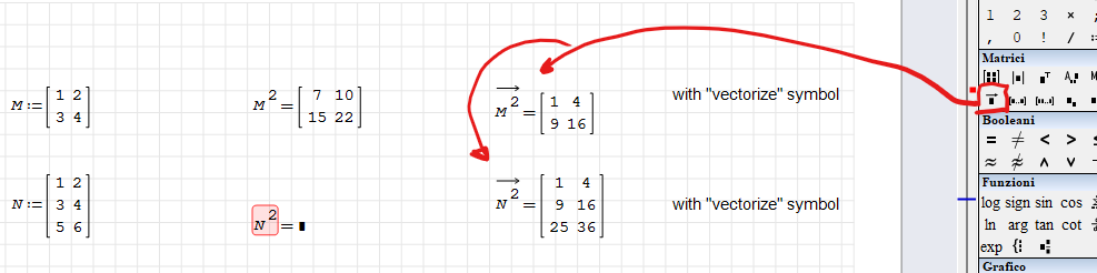

Is there a way to cause matrix operations to be performed
element by element? For example if two matrices are
multiplied, the top-left element of the multiplicand
would be multiplied by the top-left element of the multiplier
and placed in the top-left element of the product, and
so on. In mathcad this can be done by pressing -
(vectorize).

No, there is no element-wise matrix operations in Smath (like vectorize in Mathcad). You just have to use loops (for, while) to perform such operations.
