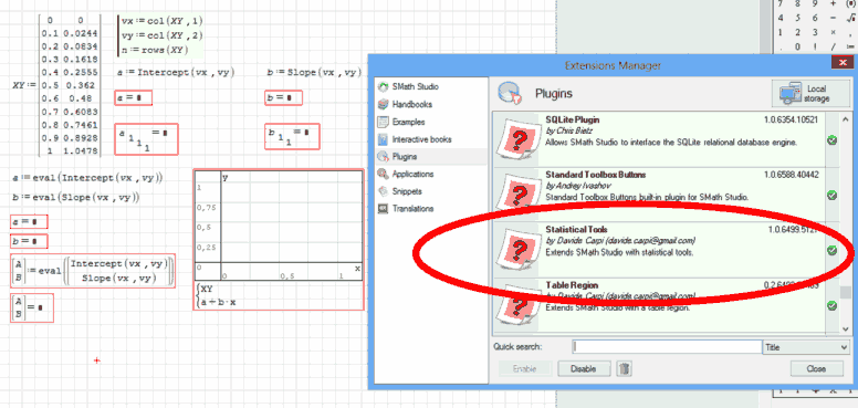

something to check in the symbolic engine; change the optimization of a:Intercept(vx,vy) from symbolic to numeric
frapuano 2017/12/7 14:40:00
#3 Posted: 2017/12/7 14:03:58
Thanks Davide ... works fine Numeric !

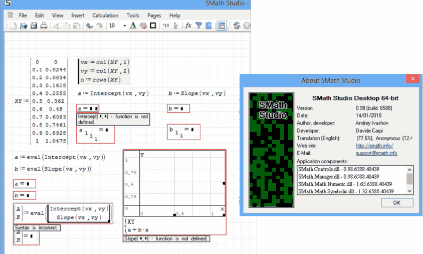

I get these errors when I run the file:
Carlos
#7 Posted: 2018/1/16 00:23:07
Carlos, try this one [done Smath 6179]
Maths SlopeIntercept.sm (9.07 KiB) downloaded 666 time(s).
#8 Posted: 2018/1/16 02:02:49
CBG
CBG
78 likes in 312 posts.
Thanks Jean, but I get the same error.
Is your Smath studio 32-bit?
My Smath Studio 64-bit, does not recognize the
functions of Interception and slope.
Carlos

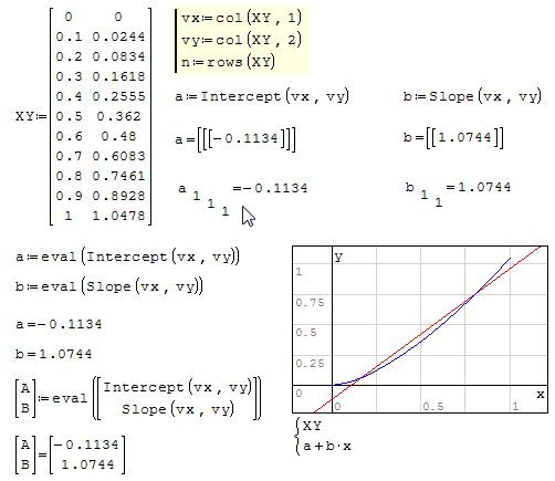

Hello!
Jean's example also works in my laptop (Win 10, 64 bit) with latest SS 6588 dated 14/01/2018.
The Functions are in Statistical Tools Plugin.
