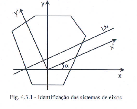

The program basically works finding the roots for f(ɑ;x.0) where ɑ is the incliantion of the neutral axis and x.0 is its depth relative to the uppermost point of the section, as in the image below.
Since it is a two variable function problem, what I do is that I use a loop to generate values of ɑ between 0 and 2π and then solve the function for each ɑ value to find its respective x.0 and then use the values of ɑ and x.0, using the secant method that I wrote myself because the interval where x.0 (the root) is not known and I need to make the interval larger in the case that the root is'nt in the first guess, to find the resisting moments of the section in the x and y axis and plot them to generate the interaction diagram.
