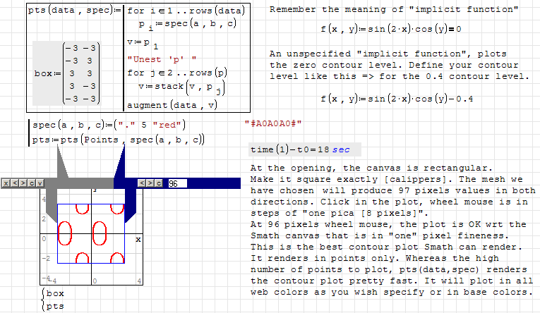

This tip may save your hairs from growing gray.
Contour ImplicitFunctionWiki.sm (22.89 KiB) downloaded 1345 time(s).
The original Wiki is inspired from Valery Ochov
from Mathsoft Collaboratory, coded in Smath Wki.

Nice
Whoever is interested in the argument, Marching Squares algorithm can be used to generate isolines.
