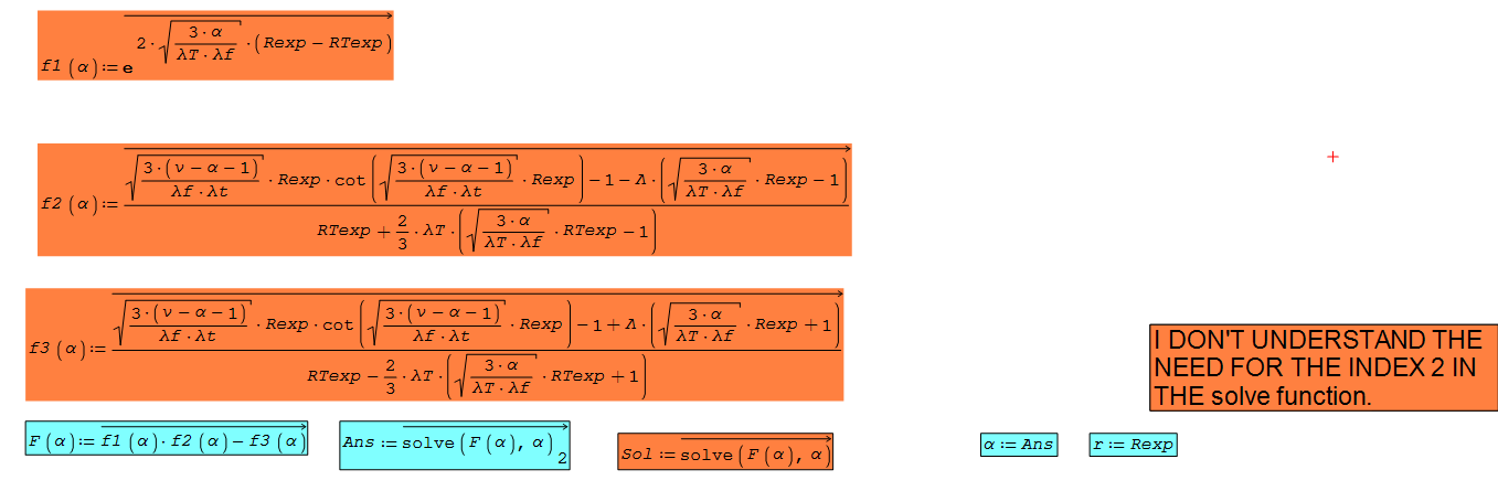

In the attached sm file, I am trying to find the roots, alpha, to a complex set of equations. To get the answer, I have to use the index 2 as noted. An image of the important part of the calculation is shown in this image.
Also, I cannot get any other root finding functions to work. I have added the maxima plugin, but that fails also. If there is a function not requiring the index that works, I would appreciate the help.

The solve function finds two solutions for each combination of Rexp, RTexp etc., the first of which is always zero. Presumably you want the non-zero solution which is the second one found, hence the subscript 2.
You could also use the four-parameter version of solve; for example: solve(F(a),a,0.001,1) which will find solutions betwee 0.001 and 1.
