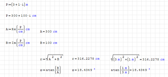

Mhhh.. I don't understand what is the problem about units and imaginary numbers...
What's the expected result?

#7 Posted: 2013/6/26 08:44:03
Mike Kaganski
Mike Kaganski
184 likes in 434 posts.
The problem is that the visual representation suggests that P is a sum of dimensionless number 300 and dimensioned imaginary 100*I centimeters (i.e. unitless number is added to a length). Surely, this is only a visual artifact, and internally the program keeps record that the unit (cm) is applied to the whole number (300+100*i), but this is yet another place where the visual representation is plain wrong.

#8 Posted: 2013/6/26 08:52:34
1,435 likes in 2,913 posts.
Thank you, now I understand the point
