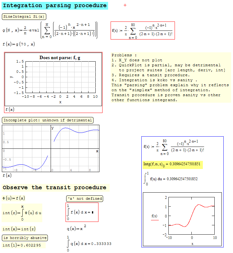

#1 Posted: 2016/6/10 12:02:11
That one is for Designers wrt the latest Nightly build.
Done in Smath 5346 OFFicial release.
jean
Maths Integration Parsing Procedure.sm (23.92 KiB) downloaded 1104 time(s).

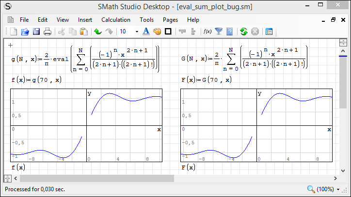

#2 Posted: 2016/6/11 09:33:19
2,340 likes in 4,041 posts.
Jean,
Thank you! Fixed. And... if previous versions of SMath Studio required eval() function to be used, now it doesn't matter anymore.
eval_sum_plot_bug.sm (7.14 KiB) downloaded 1122 time(s).
