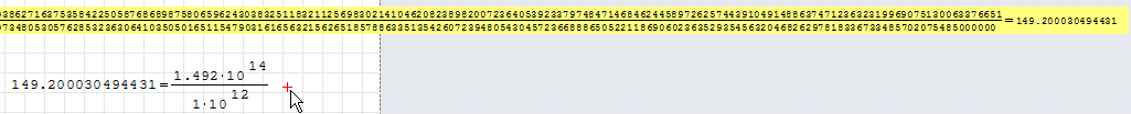

... this result is too long to be displayed in one page,
Smath does not accomodate the copy to clipboard. Only
portion is viewed. I have nothing to tell me if the long
fraction is equivalent to 64 bit.

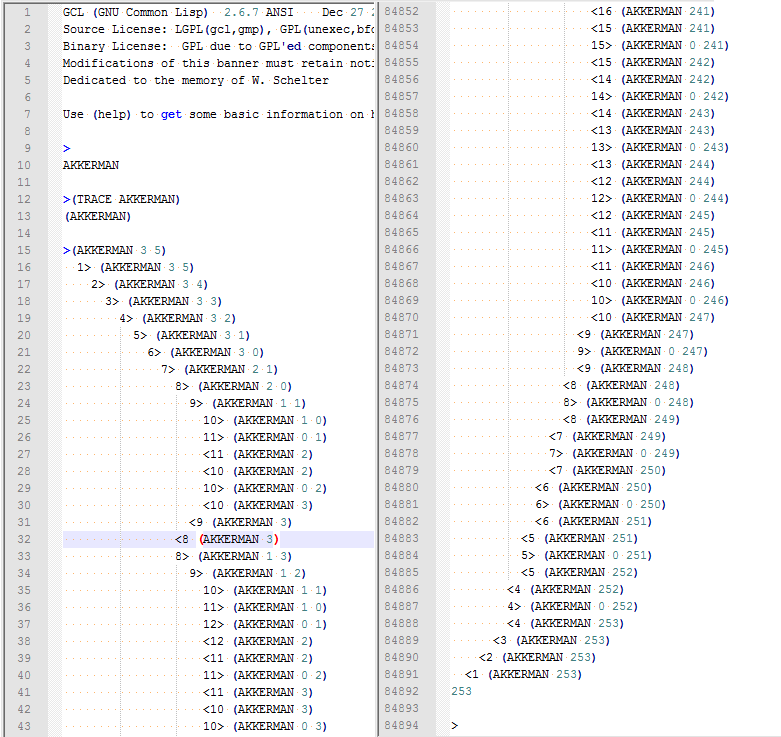

This is the beggining and the end of akkerman(3,5) tracing in GCL. As you can see, the numbers are not tremendous, but the number of numbers is tremendous.
For example, akkerman(3,4) requires 4 times less operations. As bigger stack as more conses you can add to it, no matter their values. if stack is too small it causes stack overflow.
And this is the death of akkerman(3, 6).
In opposite conner, the factorial function causes out of range error on 171 as argument, so stack is not overflown, but the product of n & fact(n-1) is out of range. And Smath is not crashes.
