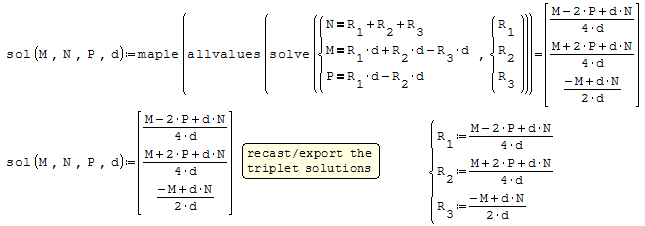

#6 Posted: 2021/8/24 12:57:45
Explicit the Triplet [R1, R2, R3]

P.S. I believe that Jean's solution is not correct because the solutions are not ordered
