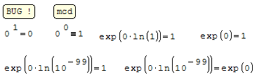

#3 Posted: 2016/7/4 14:23:22
0^0=1 is conventionalised in Mathcad, not in Smath.
Numerically, 0 is a variable. In the expansion, it first calculates ln(0)
which is undefined [uncertain]. Consequently, exp(0*ln(0))is undefined
or uncertain. On the other hand, 0^1=0 is a damned big bug in Smath.

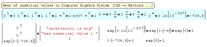

#5 Posted: 2016/7/4 23:40:00
L'Hospital is for bed time reading outside the classroom .
In CAS, we need CAS values, i.e: numerical values.
It's up to each system to be educated or voluntarily ignorant.
#6 Posted: 2016/7/5 09:49:17
In those "uncertainties", Smath report its own uncertainties.
That's not what you want in Classroom or Engineering.
Rather, you want this, that Smath should have by recognition:
