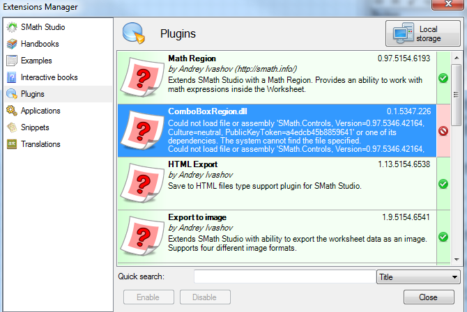

I have been using SMath for a while now, but have not tried any new plugins.
Today I tried to install the ComboBoxRegion, but it would not install. I now get an error message when the program loads. "Could not load file or assembly 'SMath.Controls, Version=0.97.5346.42164 ... The system cannot find the file specified."
I also downloaded the .zip file and placed the .dll files in the plugins folder. that did not appear to make it work either.
What might I be doing wrong that this does not load?
I also would like to know how to remove it from the list of Local storage plugins?
Is it correct to not see it in the Online gallery now?
I haven't tried any other plugins for fear that I can't remove them.
Any assistance would be appreciated.
Thank you.
Jay

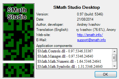

I just tried to update the program. It did not appear to install the update.
I then removed the program and installed the latest version.
0.97 (build: 5346)
8/21/2014
I now receive the following message when starting the program.
ComboBoxRegion.dll
That assembly does not allow partially trusted callers.
What do I do now???
Thanks for your help.
Jay

update...
The strangest thing...
I just exit the program.
I start the program again, and the original error is displayed and the version of the program is back to 0.97 (build: 5154) 2/10/2014
I have never seen this type of version issue.
I will try to remove again and reinstall the latest.
update...
I reinstalled for my username only and not for all users.
The version is now remaining as the latest.
I still am getting the "...partially trusted callers." message.
Davide Carpi 2014/9/9 18:56:00
Wroteupdate...
As for the initial issue, your previous version was the first stable version with the Extensions Manager, so probably skips the "target version" parameter, added later (at least in the front-end).
About the latest issue I think only Andrey can help you
