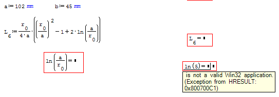

(SOLVED) HRESULT: 0x800700C1 - mushoe - Messages
hi mushoe
if you have installed one or more WIN 32 plugin delete it, then it should work
Greetings uham67
Greetings uham67

Hi Martin,
the link to the "unofficial portable version" does not work properly (Page not found)
Davide Carpi 2013/10/9 06:55:00
WroteDo you use the unofficial portable distribution? If not, you might give it a try.
This is the correct link
I tried removing all plugins from my install, but that did not work. I then tried the portable version and it solved my issue!
Thank you so very much!
I had defined r0 above, I just forgot to move it down when I took the screen shot.

WroteWroteDo you use the unofficial portable distribution? If not, you might give it a try.
Good
BTW I suggest you to follow the hint made by ioan92, sometimes something goes wrong with the installed version, a clean install can solve issues (tried myself this summer with an annoying red cross of death moving the vertical scrollbar)

Just a follow up. I have been using the unofficial portable version for a while now and it has been working as expected with no strange errors. Thanks again to all for the help!
