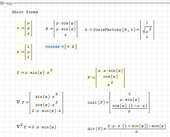

Hi. Example about how to get vectorial differential operators in a curvilinear coordinate system.
coords.sm (86.5 KiB) downloaded 1247 time(s).

Hi Martin. I prefer the 'library style' instead the 'plugin style' for developing apps for SMath. Reasons have a lot. For instance, is the maple and matlab's historical grow path. Also I can point following benefits:
- improving SMath itself, discovering better ways for doing internals, or for requesting features.
- increase of bugs discovering
- source code in high level language (SMath lang), so, more easy for debugging
- more users can collab developing or improving the libraries
The biggest disadvantage: speed. But maybe this can help Andrey to find more robust algorithms.
As an application of these comments, I have this suggestions
- Add "nabla x" and "nabla dot" like grad and lapl to custom gliphs
- Same thing, but for several variables and vectorial integrals (path, flux, etc.)
- Improve at function for handling v=P where v and P are vectors (see green comments in the attached)
- Make custom gliphs and include plugins internal
- If include can't find in the sm file in the same folder than the current file, nor the specify path, search it in some "library folder" under apps default path.
- The set of 'libraries' could be a plugin itself, and have some kind of actualization, like the others plugins, examples or handbooks.
- In the attached, the 'library' style for the differentials applications, and help for get a large collection of coordinates systems, if in case that same one want to write the 'library'
coords v2.sm (110.26 KiB) downloaded 1178 time(s).

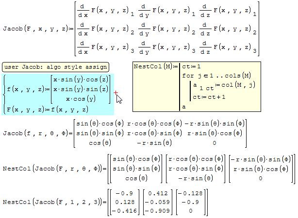

Polar integration in symbolic version:
Integral%20in%20polars_Kr.sm (57.53 KiB) downloaded 1322 time(s).
frapuano 2018/12/11 13:30:00, Arie 2018/12/11 13:51:00, Alvaro 2018/12/11 17:45:00

Some few samples.
Thanks Alvaro: gorgeous, was missing up to your work. perfect SS 6179.
Doctored for myself, because some freak coding from the original transmission.
Integral 00000 2D polar Alvaro.sm (46.95 KiB) downloaded 1189 time(s).
