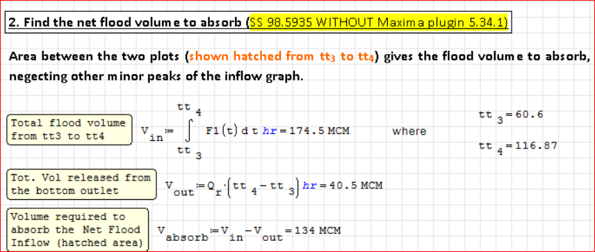

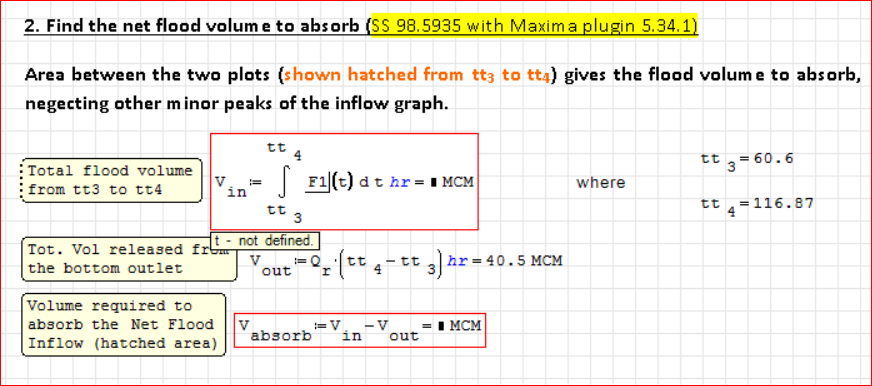

WroteI too face the same problem in definite integrals in all my SS files under 98, with Maxima 5.34.1.
These SS files ran fine under 97.
Two images WITH and WITHOUT Maxima plugin 5.34.1 attached.
SS file also attached
Reservoir Flood Capacity Estimation-R1.sm (189.41 KiB) downloaded 1177 time(s).

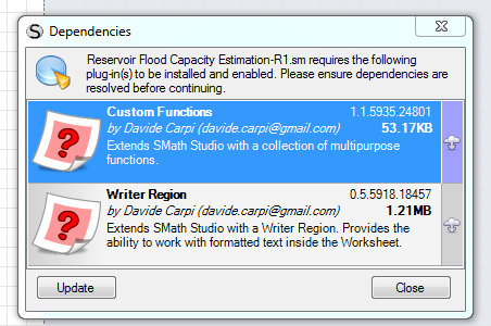

ndtma,
You have other plugins that may not be playing nice ...
I had to update "Custom Functions" and download "Writer Region"

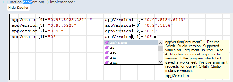

Also, in lieu of the SS version ..., use the new built in "appversion(3)=" function

The two plugins were already updated.
Before writing to the forum, I tried a clean re-installation of SS 98.5935 with minimum required plugins installed and updated.
But still the problem with Maxima plugin remains.
By the way how do you use "appversion"?
