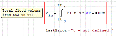

integral isn't calculated in this example. Culprit is maxima plugin. If it is installed you can't get a result.

#7 Posted: 2016/4/8 14:48:36
Integral works for me:
You are totalising an hourly rate of accumulation
over the [a,b] time limits for a total MCM [m^3]
