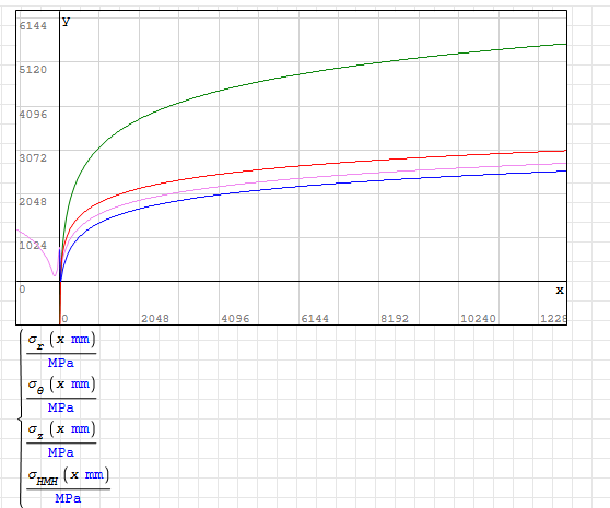

Thanks again. But how did you type this ? SMath doesn’t allow me to enter units for x if I type (x ’mm).
Also, all the plots of these functions generated by SMath (whether units are used or not) look completly different than in the book (as you can see in a picture attached to my first post here) and in Excel. Maybe that’s because of the large values on both axes. Zooming closer takes ages since SMath has to recalculate. Is there a way to set range for x axis (so that I can see the curves starting from x=30 to x=40) ?
x * mm to insert units

Yes, the plot should be for s understood as r from 30 to 40. Zooming in with mouse wheel doesn’t help - y axis adjusts but x axis remains at very hight values.

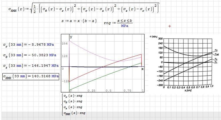

... like this two ways plot.
Thick-walled pipe thermal stress_plot.sm (182.52 KiB) downloaded 1041 time(s).
WroteYes, the plot should be for s understood as r from 30 to 40.
So, s=a+x*(b-a) and it is restricted by the range rng=lele(s,a,b ) / 'MPa . Just include the scale factor MPa here for comfortability.
WroteZooming in with mouse wheel doesn’t help - y axis adjusts but x axis remains at very hight values.
Use Ctrl-wheel for zoom only y-axis and Shift-wheel for x-axis.

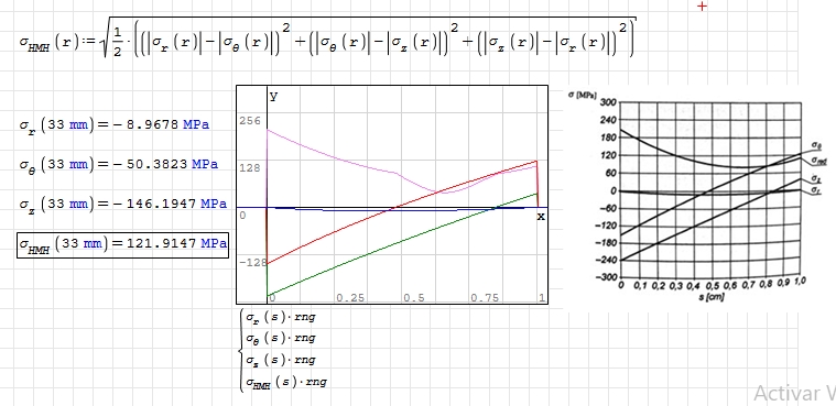

I modify your von Mises stress formula for yielding taking out abs values, so for r=33 mm it gets σ.HMH(33*'mm)=140.3168@'MPa. But with this modification plots looks very similar now:
With the abs values it have some erratic behavior:
