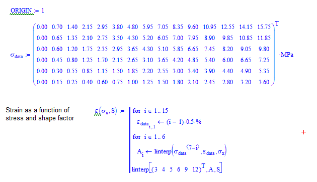

Capture.PNGI have a MathCAD sheet that I am trying to convert to be able to use in SMath. I have attached a few lines from the MathCAD sheet that I am having problems with. How can you achieve the same thing in SMath, since there isn't a local definition operator that I can find in SMath? Thanks!!
#2 Posted: 2019/12/12 16:32:16
The local definition is <- is simply :=
You should be able to spline your matrix from there.
SplineRectangularMatrix.sm (86.59 KiB) downloaded 1027 time(s).
#3 Posted: 2019/12/12 16:42:03
1,123 likes in 1,795 posts.
Hi. SMath doesn't have the Mathcad column extractor as operator, but as function: you can use col(sigma.data,7-j). Also, notice that i=sqrt(-1) is SMath, this is, not 1i, like in mathcad.
